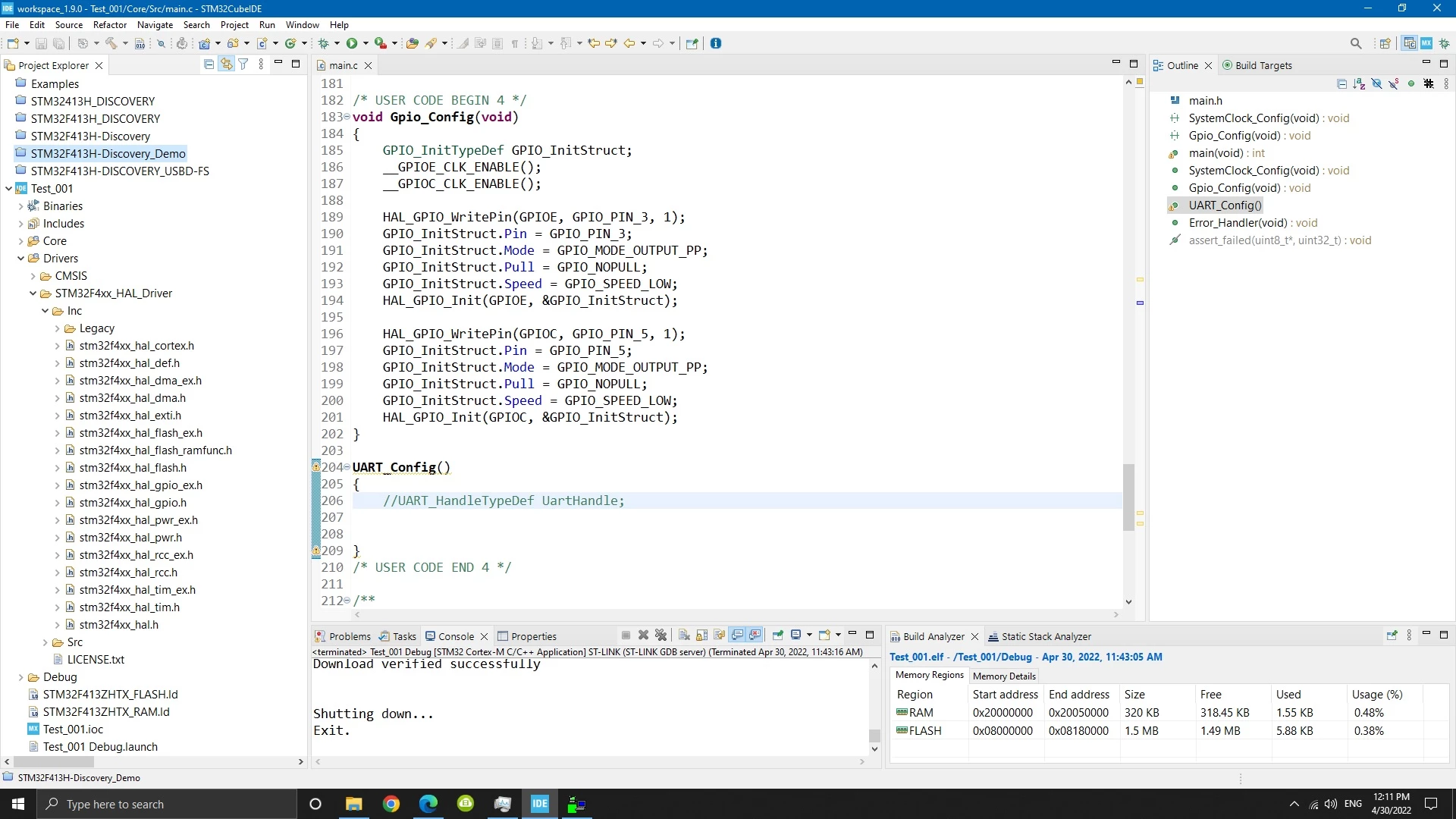

missing stm32f4xx_hal_uart.h in STM32F4xx_HAL_Driver
I recently go the 32F413HDISCOVERY board and downloaded the projects and examples to a local folder and imported it all of it into STM32CubeIDE.
In the STM32CubeIDE I was able to open and modify the Test_001 project and blink LED2 and LED3.
Next, I wanted to send and receive some text from HyperTerminal on the PC, but it turns out the STM32F4xx_HAL_Driver does not include anything UART related in the Test_001 project.
The attached screen shot (Test_001 Drivers.jpg) shows everything in Test_001 \Drivers\STM32F4xx_HAL_Driver\Inc...stm32f4xx_hal_uart.h is missing.
How can I enable (bring in) stm32f4xx_hal_uart.h in the Test_001 project?
TDKBest answer
Apr 30, 2022 5:49 PM UTC
Edit the IOC file, enable a UART peripheral, and re-generate the code. It will then include the UART library files and enable them within HAL.

Apr 30, 2022 6:13 PM UTC
If you don't want to edit the IOC, you could also drag/drop the files into those folders from the repository and edit your stm32f4xx_hal_conf.h file to include the define for HAL_UART_MODULE_ENABLED.
By default, on Windows, the repositories are located at:
C:\Users\%USERNAME%\STM32Cube\Repository

May 1, 2022 2:53 PM UTC
I am new to ST and the development environment and didn't realize the IOC file opens up into a configuration tab. I was searching for a button on the toolbar.
Thanks for the two separate approaches! It is working now.:ok_hand:
