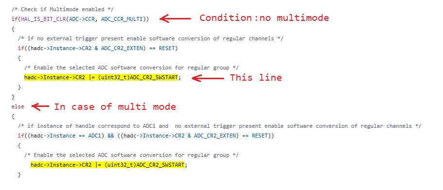

Missing case for ADC2 software start in STM32f7xx HAL driver HAL_Adc_Start_IT()
Looks like the HAL driver for the STM32f7xx ADC is missing a case for using the software start of the ADC2 peripheral in the HAL_ADC_Start_IT function.
Starting from line 1128:
 else
 /* if instance of handle correspond to ADC1 and no external trigger present enable software conversion of regular channels */
 if((hadc->Instance == ADC1) && ((hadc->Instance->CR2 & ADC_CR2_EXTEN) == RESET))
 /* Enable the selected ADC software conversion for regular group */
 hadc->Instance->CR2 |= (uint32_t)ADC_CR2_SWSTART;
 /* if dual mode is selected, ADC3 works independently. */
 /* check if the mode selected is not triple */
 if( HAL_IS_BIT_CLR(ADC->CCR, ADC_CCR_MULTI_4) )
 /* if instance of handle correspond to ADC3 and no external trigger present enable software conversion of regular channels */
 if((hadc->Instance == ADC3) && ((hadc->Instance->CR2 & ADC_CR2_EXTEN) == RESET))
I think ADC2 should also be considered in this function. In fact, it is not mentioned anywhere in this driver...

It's considered at this line:
Condition: No ADC multimode configured.
Knowing that in multimode ADC1 is the master.

You are right, I accidentally enabled the multi mode by writing too large a value to CCR->ADCPRE...
