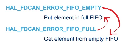

There seems to be a recurring error in the HAL documentation (e.g. UM2570, but also in others  STM32L5?)
UM2570 - Rev 2 page 60/2926
The description of the flag does not match the flag name
HAL_FDCAN_ERROR_FIFO_EMPTY
Put element in full FIFO
HAL_FDCAN_ERROR_FIFO_FULL
Get element from empty FIFO

I’ll escalate that for analysis and eventual fix.
They seem to be swapped:
Internal ticket for follow-up: CDM0064279
No: they are error flags - not functions or actions.

Swapped + they are flags not functions.
I’ll escalate that too.

expected somethig like:
FIFO empty error
FIFO fill error
