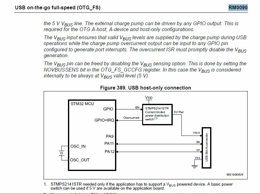

Hi guys,
does anyone draw a circuit to get the stm32F4 MCU with USB connector working properly .
Thanks
2 replies
Vangelis Fortounas
April 5, 2019
Inside reference manual there is a minimum "schematic" for OTG USB FS in Host mode.
F4 series has an internal FS PHY.
I tried it and it works properly.
Although EMI filters and ESD protection, both are recommended.
Most cheap Chinese F407VG boards use this minimal configuration.
