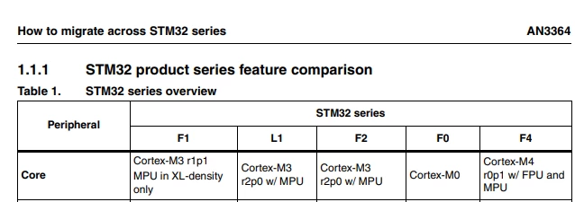

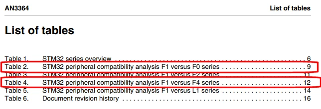

Doesn't combining Tables 2 & 4 give you F4 vs F0:
See also Table 1;
Going from F4 to F0 is a "downgrade"

"Doesn't combining Tables 2 & 4 give you F4 vs F0:"
Sort of... :smiling_face_with_smiling_eyes:

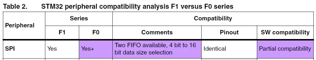

Taking the ADCs as an example:
F1 vs F0
F1 vs F4
This tells me that the ADC is different to the F1 on both the F0 and F4. But it doesn't tell me if the F0 and F4 are the same (I suspect not).

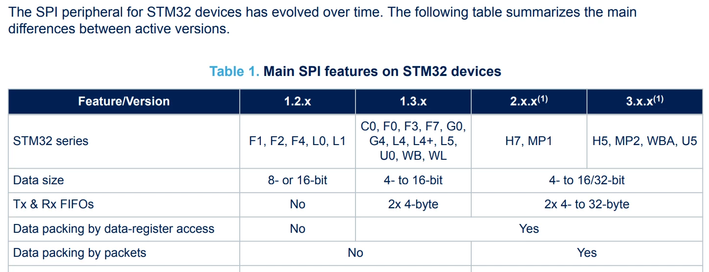

Another example, I know the SPI on the F0 and F4 are different, as the F0 uses version 1.3 of the SPI peripheral, rather than the 1.2 version in F1 and F4 (as described in AN5543).
This is covered in the tables, and can be understood, but only because the F1 and F4 are fully software compatible (hence I assume they operate the same, but are de-featured at the lower IC):

@###### F0 is newer than F4 by release date, this explains that its peripheral IPs are newer. But its CPU is M0 (not even M0+) compared to M4-FPU of the F4.
Summary of peripherals unfortunately is not easy to find.  Please refer to the RM and DS documents of the specific parts. Some people managed to dig this information out of CubeMX database.

SPI and I2C are quite different between 'F4 and 'F0 (and UART is partially different, too), as there was a relatively major rework of these peripherals exactly between 'F4 and 'F0.
