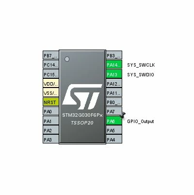

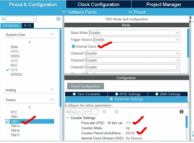

Hello I am trying to work with Microseconds delay in my code
so follow this very help full post on web POST
and I configure TIMER 3 ( I have also check with all available timer )
But unfortunately, it doesn't work for my STM32GO3O MCU
/* USER CODE BEGIN 0 */
void delay(uint16_t delay)
__HAL_TIM_SET_COUNTER (&htim3,0);
while (__HAL_TIM_GET_COUNTER(&htim3)<delay);
/* USER CODE END 0 */
while (1)
    /* USER CODE END WHILE */
    /* USER CODE BEGIN 3 */
  HAL_GPIO_TogglePin(GPIOA, GPIO_PIN_6);
  delay(50);

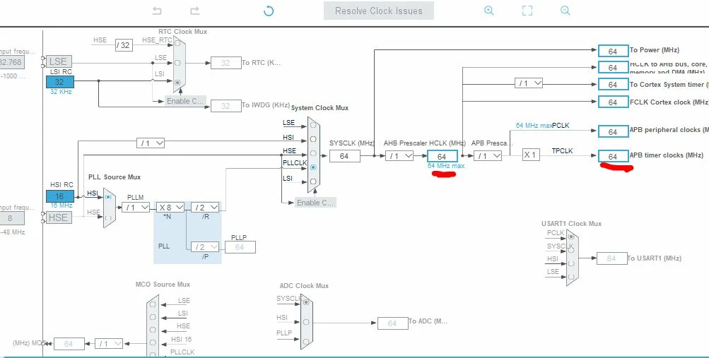

I don't have any external crystal oscillator attached ..
I used pin PA6 to debug the pulse output on the oscilloscope. but PA6 not changing the state.
please help how can I able to work with microseconds delay in STM32G030

Can you see TIM3 CNT cycling thru 0x0000 .. 0xFFFF in the debugger peripheral view?
For 64 MHz and 1us ticks set Prescaler to 64-1
I'd delta the count rather than zero the count,  as that would be thread/interrupt safe.

no increment observed int the counter.

Did you start the timer?
sandeep3Author
Dec 9, 2023 1:53 PM UTC
I think I miss as I am new to stm32 please guide how to start the timer.
STTwo-32
STTwo-32Best answer
Dec 9, 2023 2:03 PM UTC
Hello @sandeep3
You need to add HAL_TIM_Base_Start(&htim3) to the main loop after the initialisation of all peripherals.
Best Regards
STTwo-32
