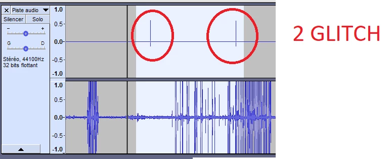

I am trying to develop a noise canceling microphone using the STM32F401RET6 based on the software Acoustic_BF provided by the package X-CUBE-MEMSMIC1 :
https://www.st.com/en/embedded-software/x-cube-memsmic1.html
In this software the audio is sent to the PC by USB and instead of sending through USB I want to send it via the I2S3 BUS.
I encounter two problems :
1) When I try to enable the DMA of the i2s3 channel the BEAMFORMING stop working. When I visualize the audio data using audacity, only the audio channel not processed by the beamforming remain. The audio who supposed to be beamformed have some glitch (two glitch in the picture below) but the signal remain at 0 for the rest of the time.
The input I2S2 (DMA_CHANNEL_3, DMA2_Stream2) doesn't seem to use some common DMA with the output (DMA1_Stream5, DMA_CHANNEL_0) so the beamforming shouldn't been affected by the DMA output of the I2S3. Is there incompatiblity for performing the beamforming and sending it to the I2S3 at the same time ?
