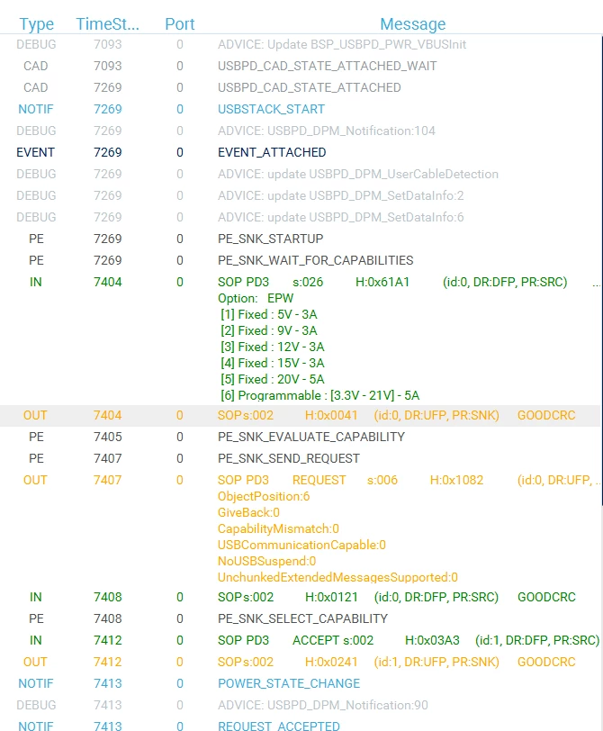

nikolai2111
Nov 10, 2022 4:06 PM UTC
Thank you for your quick reply!

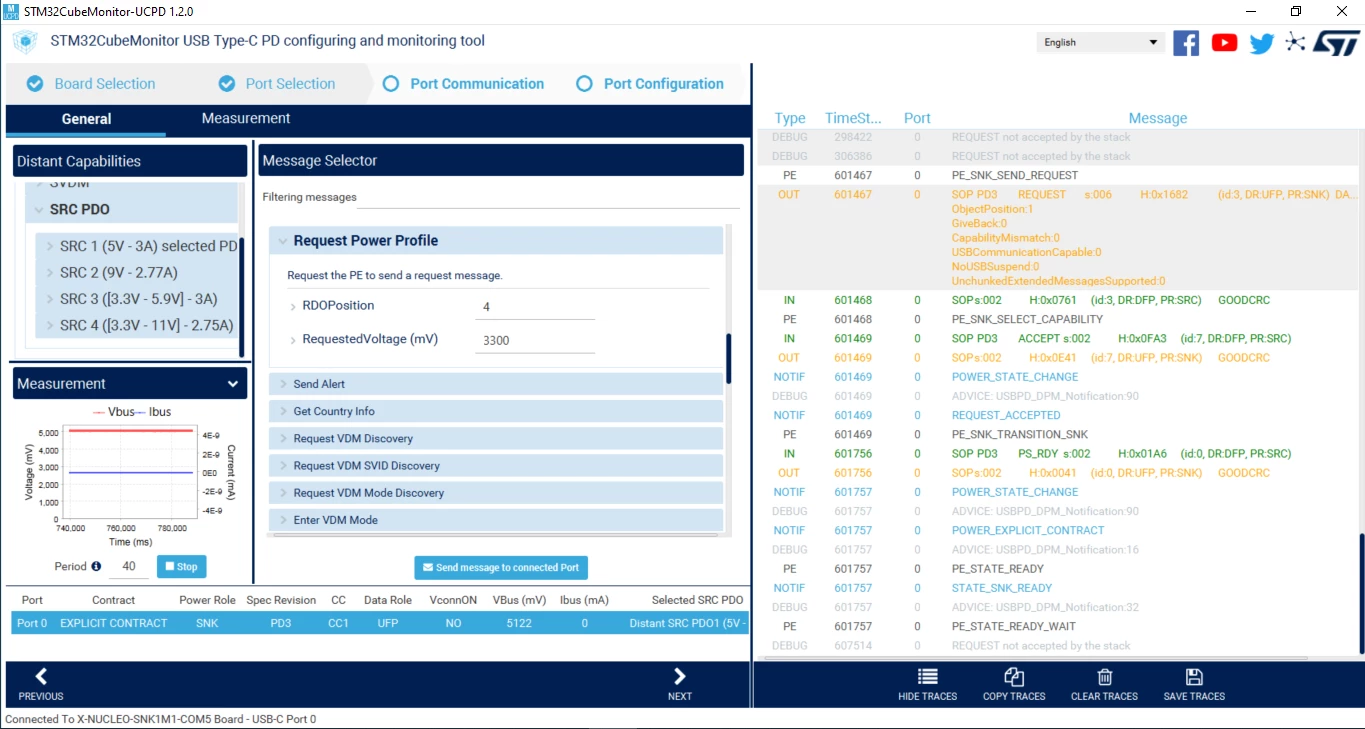

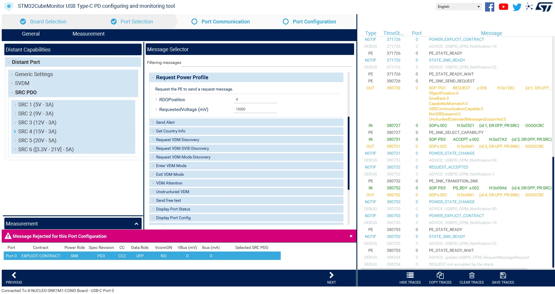

Sorry, the images were not uploaded/attached. However, I have manually adjusted them to the PDO of the source via the UCPD Monitor / Port Configuration / Sink Capabilities.
 0693W00000WI2D6QAL.png0693W00000WI2CwQAL.png0693W00000WI2DpQAL.png0693W00000WI2CmQAL.png
nikolai2111
Nov 13, 2022 4:02 PM UTC
Now after further investigation I noticed that only after a hard(-ware) reset the correct PDO is selected? Is this how it is supposed to be?

In your case if you look at the very end of the trace where the message is rejected, you will see "ADVICE: update USBPD_DPM_RequestMessageRequest", which means that you are trying to use a function which is not implemented yet on this simple example. This is user code that you can make according to your needs.
If you search for the actual USBPD_DPM_RequestMessageRequest function, you will find a short explanation on what you could do with your implementation.
As a quick example to just make what you were trying to do on STM32CubeMonitorUCPD work, you can try this code:

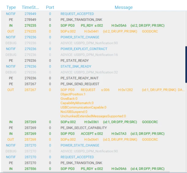

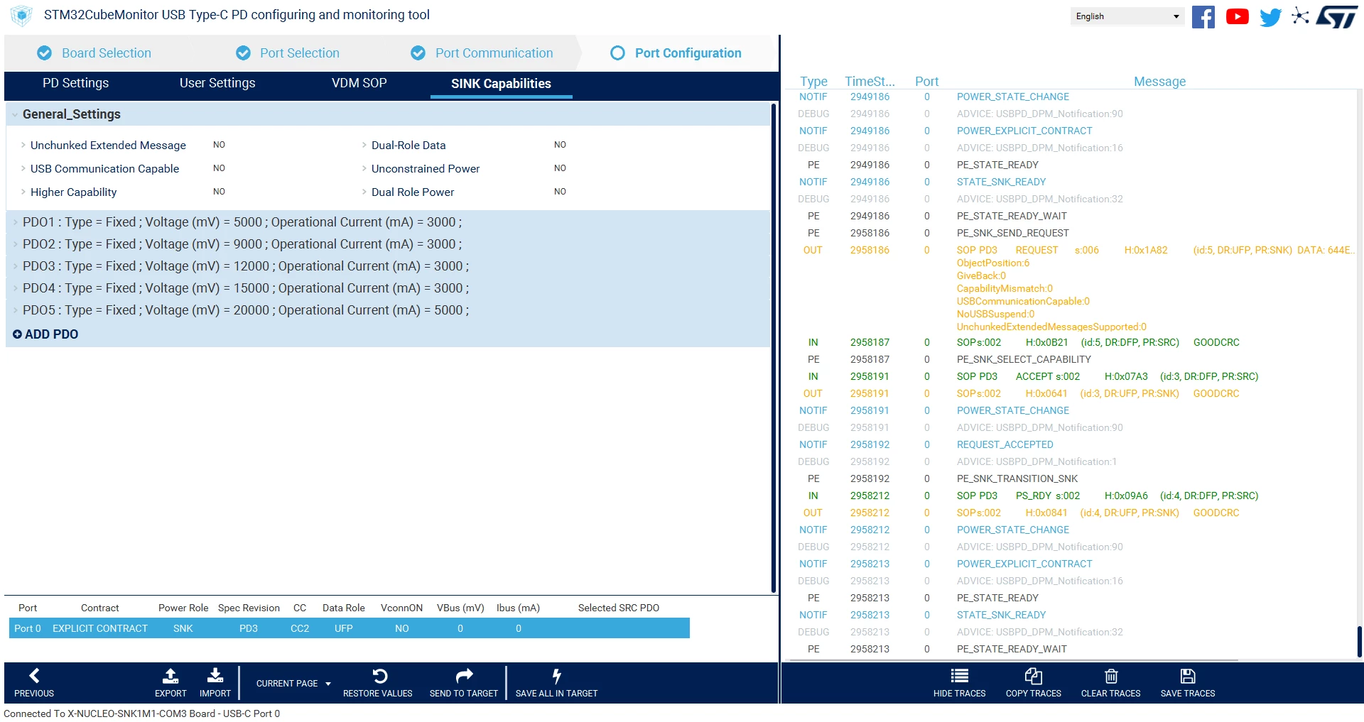

FelipeFRL
Visitor II
Apr 10, 2023 11:15 AM UTC

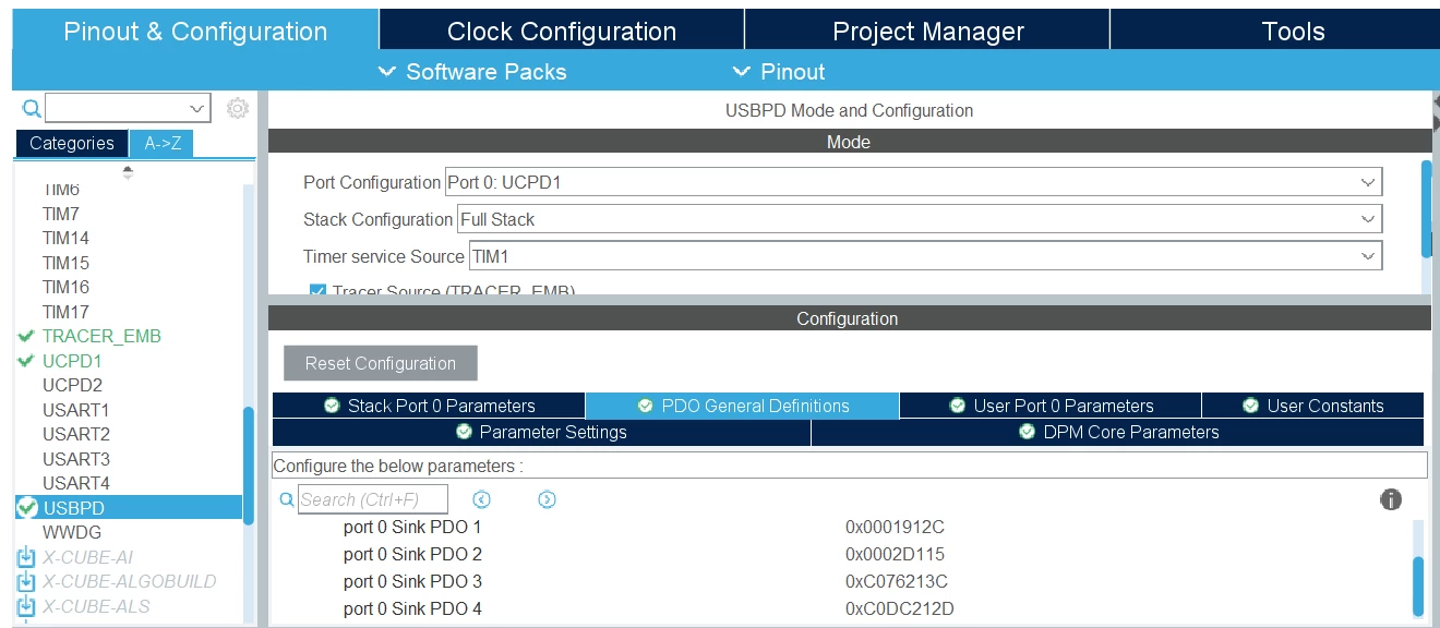

I used this code for my G071RBT6 nucleo board with a 4 PDOs power supply (2 fixed and 2 APDOs), and the only PDO that can be requested is the first. Can't even request the one that it initializes with (the highest powered, 4th PDO, 11V@2.25A). I request the PDOs listed in UCPD Monitor but I get "request not accepted by the stack". It seems like the board can't recognize the received PDOs even though I can see them on UCPD Monitor and they're exact to specification. Maybe the PDOs are received by UCPD but ill-defined on the code/STM32CubeMX.
I already understood from the USB IF specification that the 4 byte value defines the PDO bit by bit.
I got to request the two APDOs but not quite, as I can only request them with their maximum voltages. Why can't I request them with lower voltages aka inside their operating range?
And why can't I request the second fixed PDO? It doesn't make sense.
Can't seem to understand what could be happening. Can someone shed me some light?
Here are my CubeMX definitions:

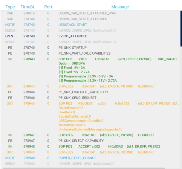

HFISTM
Apr 11, 2023 6:59 AM UTC
Hello @FelipeFRL​ ,
Could you please send your trace ? It will be hard to help without it.
As I can see from your cube MX screenshot is that you declared that your board would take one of the following power profile:
  • 5V 3A
  • 9V 2.77A
  • APDO 3.3-5.9V 3A
  • APDO 3.3-11V 2.25A
I assume that these are your maximum source capabilities (It could be seen in the trace). I suspect that you are not able to select a PDO because you request exactly the maximum of your source and the source declines the request.
Maybe try to lower the requested current to see if that helps. Again, we will need to look at the trace when you ask for a PDO and get the not accepted message to see what's really happening.
Regards

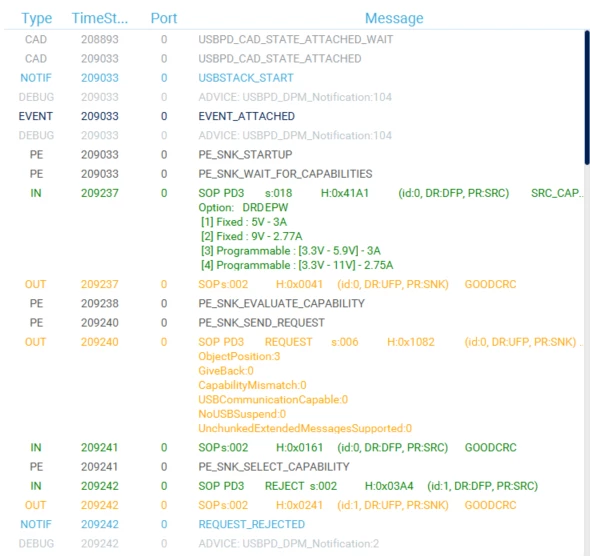

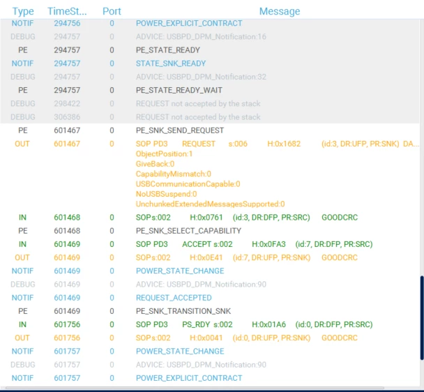

FelipeFRL
Visitor II
Apr 11, 2023 11:22 AM UTC
Thanks for the fast reply!

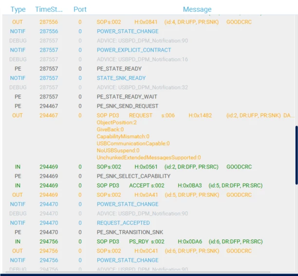

The thing is, it ONLY accepts the APDOs requests when I request them at maximum voltage, and only then. I can't request them at a lower voltage, like their minimum 3.3V or any other voltage on the operational range.
Another issue, am I able to measure the current with this hardware (STM32G071RBT6 NUCLEO Board w/ SN1M1 Expansion Board) or do I need an external IC to sense curent with the ADC? If i can without another IC, where can I find the basic code to implement this?
Anyway, here are my traces and the port communication window in UCPD Monitor. At first it requested the highest powered PDO which is 11V@2.25A, then I requested manually the 5V fixed PDO, then 9V fixed PDO and at last the two APDOs with lower voltage than the maximum and I got "request not accepted by the stack".
HFISTM
Apr 11, 2023 11:39 AM UTC
Thank you for your images but unfortunately there is a lot of the trace missing (source capa for example), could you please share it in .cpd format ? Please refer to this wiki.
According to the image you shared, each time you requested the power profile the source accepted it. Did it not worked (except from the message you got on ucpd monitor) ?
You can measure the current drawn on VBUS by completing the BSP_USBPD_PWR_VBUSGetCurrent function
Regards

FelipeFRL
Visitor II
Apr 11, 2023 12:04 PM UTC

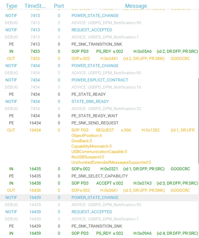

It didn't at the last image, when I requested the 3.3V-5.9V APDO with 3.3V. The last message is "DEBUG 607514 REQUEST not accepted by the stack", which is the response to this last request.
About the VBUSGetCurrent function, I tried copying the code from VBUSGetVoltage, changing variables and the multiplier but can't seem to make it work as I get false current readings (when comparing with multimeter and with current oscilloscope probe too). Where can I find a code exemple that really works?
Here are all the traces in text, even though SRC CAPA can be seen coloured at the first image:

52 OUT 294467 0 SOP PD3 REQUEST s:006  H:0x1482  (id:2, DR:UFP, PR:SNK) DATA: 15550420 / ObjectPosition:2 / GiveBack:0 / CapabilityMismatch:0 / USBCommunicationCapable:0 / NoUSBSuspend:0 / UnchunkedExtendedMessagesSupported:0
53 IN 294469 0 SOP s:002  H:0x0561   (id:2, DR:DFP, PR:SRC) GOODCRC
54 PE 294469 0 PE_SNK_SELECT_CAPABILITY
55 IN 294469 0 SOP PD3 ACCEPT s:002  H:0x0BA3   (id:5, DR:DFP, PR:SRC)
56 OUT 294469 0 SOP s:002  H:0x0A41   (id:5, DR:UFP, PR:SNK) GOODCRC
57 NOTIF 294470 0 POWER_STATE_CHANGE
58 DEBUG 294470 0 ADVICE: USBPD_DPM_Notification:90
59 NOTIF 294470 0 REQUEST_ACCEPTED
60 PE 294470 0 PE_SNK_TRANSITION_SNK
61 IN 294756 0 SOP PD3 PS_RDY s:002  H:0x0DA6   (id:6, DR:DFP, PR:SRC)
62 OUT 294756 0 SOP s:002  H:0x0C41   (id:6, DR:UFP, PR:SNK) GOODCRC
63 NOTIF 294756 0 POWER_STATE_CHANGE
64 DEBUG 294756 0 ADVICE: USBPD_DPM_Notification:90
65 NOTIF 294756 0 POWER_EXPLICIT_CONTRACT
66 DEBUG 294757 0 ADVICE: USBPD_DPM_Notification:16
67 PE 294757 0 PE_STATE_READY
68 NOTIF 294757 0 STATE_SNK_READY
69 DEBUG 294757 0 ADVICE: USBPD_DPM_Notification:32
70 PE 294757 0 PE_STATE_READY_WAIT
71 DEBUG 298422 0 REQUEST not accepted by the stack
72 DEBUG 306386 0 REQUEST not accepted by the stack
73 PE 601467 0 PE_SNK_SEND_REQUEST
74 OUT 601467 0 SOP PD3 REQUEST s:006  H:0x1682  (id:3, DR:UFP, PR:SNK) DATA: 2CB10410 / ObjectPosition:1 / GiveBack:0 / CapabilityMismatch:0 / USBCommunicationCapable:0 / NoUSBSuspend:0 / UnchunkedExtendedMessagesSupported:0
75 IN 601468 0 SOP s:002  H:0x0761   (id:3, DR:DFP, PR:SRC) GOODCRC
76 PE 601468 0 PE_SNK_SELECT_CAPABILITY
77 IN 601469 0 SOP PD3 ACCEPT s:002  H:0x0FA3   (id:7, DR:DFP, PR:SRC)
78 OUT 601469 0 SOP s:002  H:0x0E41   (id:7, DR:UFP, PR:SNK) GOODCRC
79 NOTIF 601469 0 POWER_STATE_CHANGE
80 DEBUG 601469 0 ADVICE: USBPD_DPM_Notification:90
81 NOTIF 601469 0 REQUEST_ACCEPTED
82 PE 601469 0 PE_SNK_TRANSITION_SNK
83 IN 601756 0 SOP PD3 PS_RDY s:002  H:0x01A6   (id:0, DR:DFP, PR:SRC)
84 OUT 601756 0 SOP s:002  H:0x0041   (id:0, DR:UFP, PR:SNK) GOODCRC
85 NOTIF 601757 0 POWER_STATE_CHANGE
86 DEBUG 601757 0 ADVICE: USBPD_DPM_Notification:90
87 NOTIF 601757 0 POWER_EXPLICIT_CONTRACT
88 DEBUG 601757 0 ADVICE: USBPD_DPM_Notification:16
89 PE 601757 0 PE_STATE_READY
90 NOTIF 601757 0 STATE_SNK_READY
91 DEBUG 601757 0 ADVICE: USBPD_DPM_Notification:32
92 PE 601757 0 PE_STATE_READY_WAIT
93 DEBUG 607514 0 REQUEST not accepted by the stack

FelipeFRL
Visitor II
Apr 12, 2023 12:49 PM UTC
Dear @HFISTM​ ,
I'm debbuging the hell out of this aplication, and the problem seems to be within line 432 of usbpd_user_services.c file. The USER_SERV_SNK_EvaluateMatchWithSRCPDO function passes only the max possible voltage to the RequestedVoltage variable used in ResquestMessageRequest function, then causing its if condition of equality between voltage and RequestedVoltage to be False, which then traces the Debug message "REQUEST not accepted by the stack". I just don't know what value to use on line 432 for it to proceed in the right way.
After commenting out this line, the application seems to be out of control, as it won't establish a contract. The hardware it keeps unstoppably requesting for the APDO to be instated, rejecting the request and then resetting, over and over.
Here you can see one iteration of this unending cycle of madness:
Regards,
Felipe
