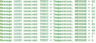

I tried to run the MQTT application available in the STM32u5 Firmware Package (version 1.1.1).
I just reduced the time between each pub to 10 and run the test forever :
0693W00000YAajwQAD.png...
I reached more than 15000 message sent and the problem is never reproduced on my side.

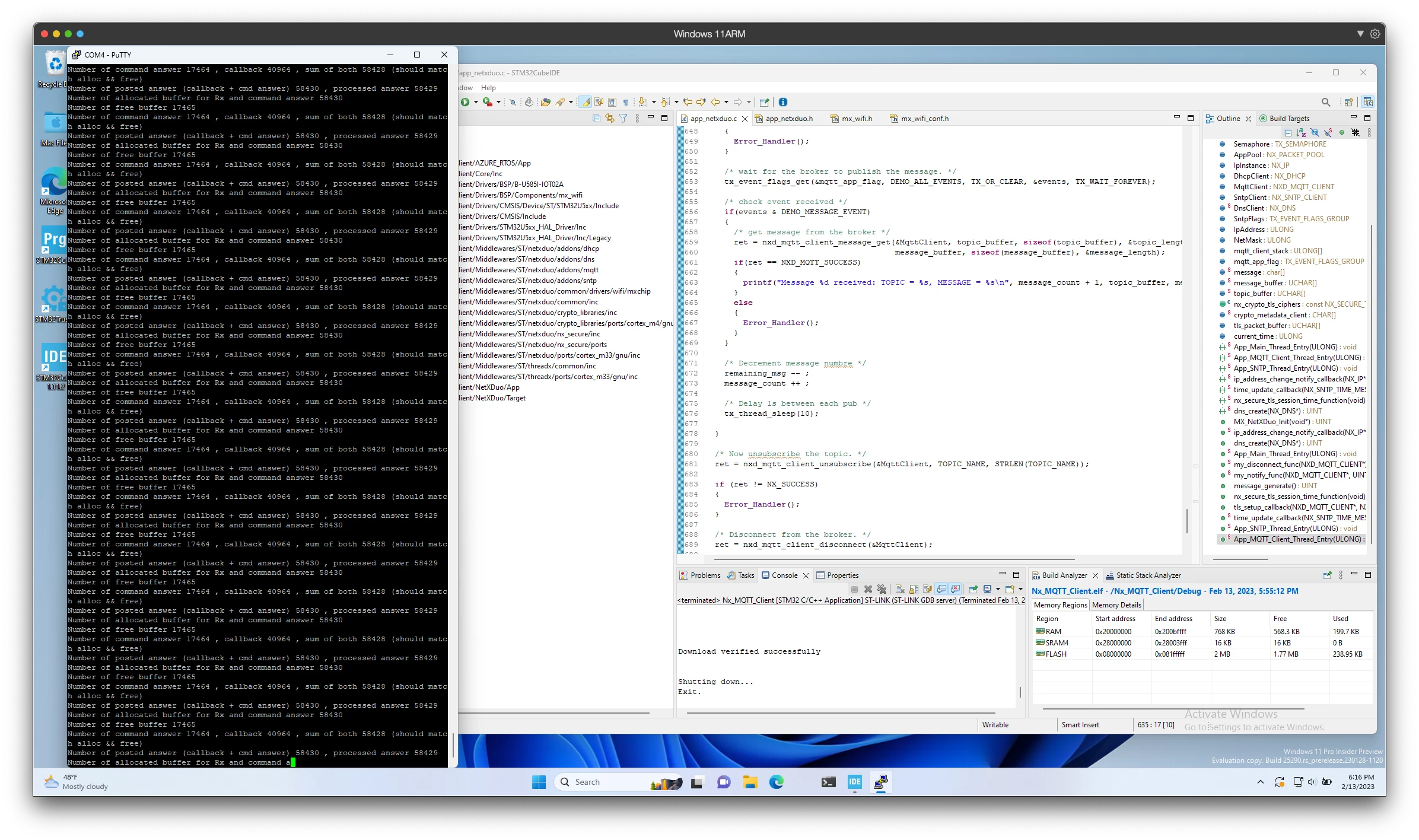

0693W00000YAdbCQAT.pngHi Mahdy,
I loaded a fresh Windows 11 with the latest STM32CubeIDE and imported the current Nx_MQTT_Client example. Changes as detailed above (plus WIFI_SSID and SSID_PASSWORD in mx_wifi_conf.h). Downloaded the compiled image to STM32U5 p/n 497-B-U585I-IOT02A-ND. It ran really well until it got to around 9000 messages and then ***BOOM***.
That 9000 messages is not cast in concrete, it really can crash earlier or later.
Please let me know if I can help with more info or tests.
Thanks again for your help - I'm dependent on this board being stable using RTOS/WiFi/MQTT/Encryption.
Regards,
--Alen
