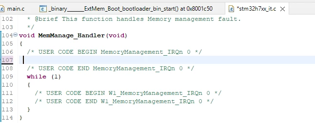

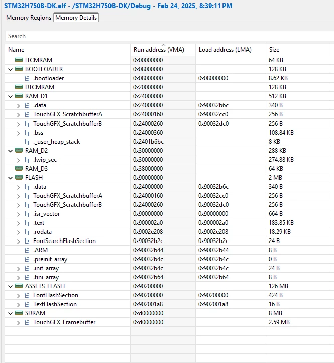

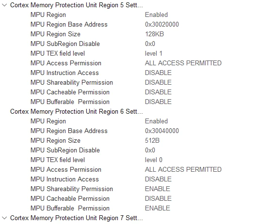

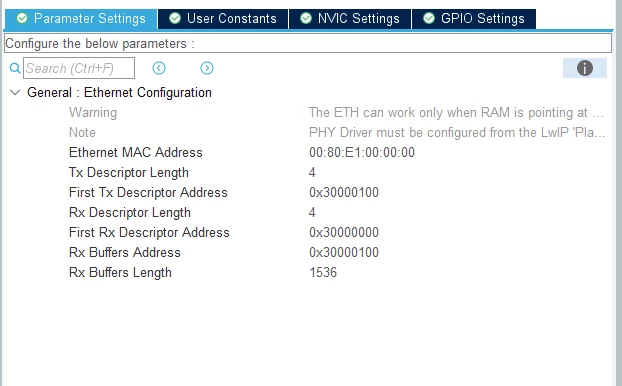

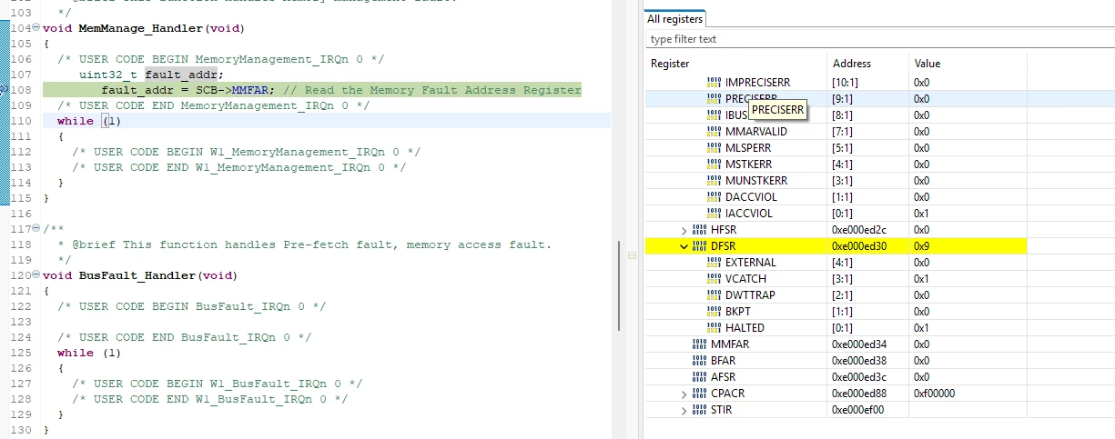

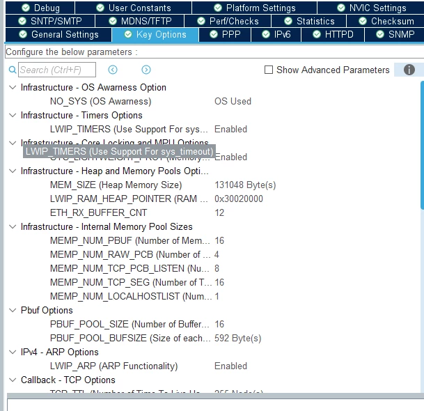

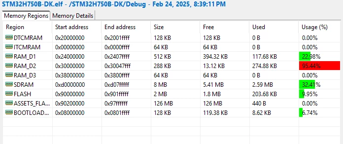

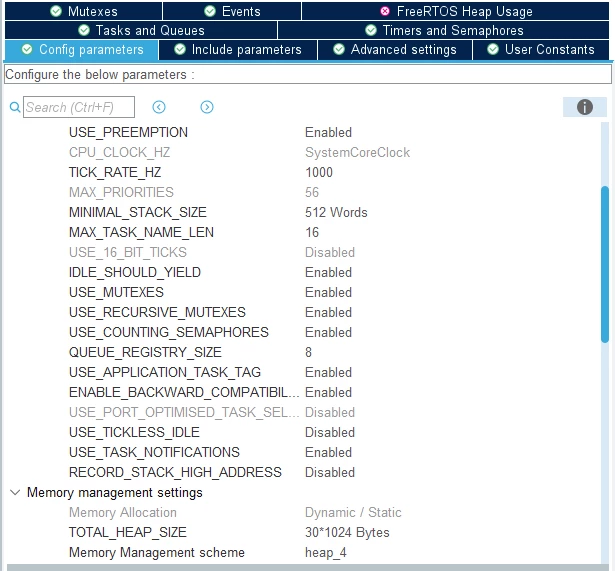

          I have setup the following parameters to run ETHERNET Using STM32H750B-DK Board and I am getting void MemManage_Handler(void) Error.

You can refer to this article on how to "How to create a project for STM32H7 with Ethernet and LwIP stack".
Same MPU config and same memory usage.

Without Using FREERTOS the above specified Program runs perfectly, But After integrating ETHERNET and LWIP I am getting MemManage_Handler(void) Error.
