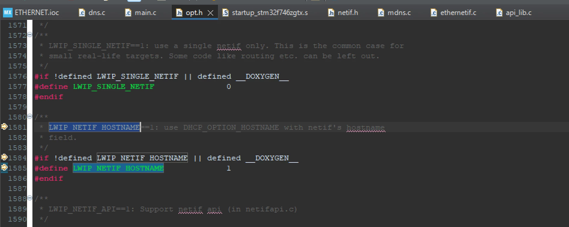

I'm tying to setup TCP server using ethernet communications (Nucleo-F767ZI) and find that I can ping the board using the router allocated IP address but I'd like to do the same using Hostname. In STM32CubeMx .ioc file, under Network Interface Options, LWIP_ENABLE_NETIF_HOSTNAME is set to 'enable' and I've set the host name I want to use in LWIP_NETIF_HOSTNAME to 'my_lwip'. However, I still find that I cannot ping the board using the hostname. I know my router DNS is working Ok because I can ping a Raspberry Pi using it's host name.

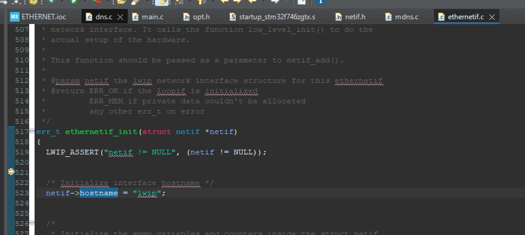

I realize that in STM32CubeMX generated lwipopts.h #define LWIP_NETIF_HOSTNAME is set to my_lwip by default but I change this to 1 manually. Otherwise, in ethernetif.c, the statement netif ->hostname - "my_lwip" is not enabled.

I could ping my device via the IP attained through DHCP but not through hostname. Looks like the default is set as "lwipW . I tried to ping lwip and lwip.local
I also override the
Attached my ethernet.ioc in case if you take a look and help me please.
