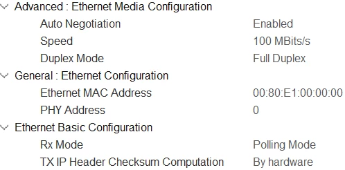

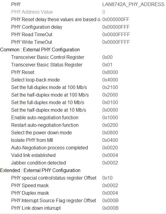

MCU freeze on Ethernet connection, on Olimex STM32-E407 Rev.F
First I'm new to the STM environment.

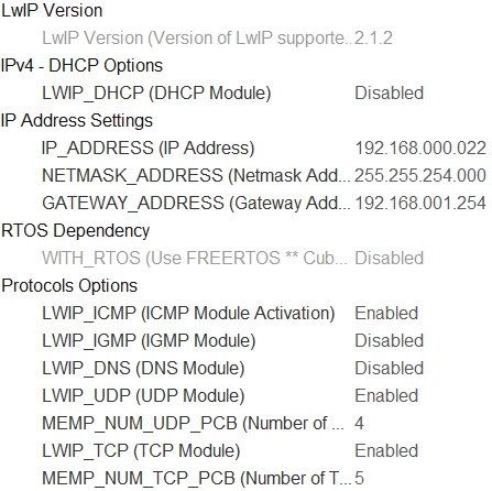

I'm setting up the Board to test some stuff, with raw LwIP. I'm having a weird issue, where the board freezes when i plug in a connected ethernet cable.
I made no other changes (exept one, look below point 3)
Code (tcpecho_raw_init is from an example:(
int main(void)
 HAL_Init();
 SystemClock_Config();
 MX_GPIO_Init();
 MX_LWIP_Init();
 LED_timer = TCP_timouts_timer = HAL_GetTick();
 tcpecho_raw_init();
 while (1)
 if (TCP_timouts_timer < HAL_GetTick())
 sys_check_timeouts();
 TCP_timouts_timer = HAL_GetTick() + 5;
 if (LED_timer < HAL_GetTick())
 HAL_GPIO_TogglePin(LED_PIN_GPIO_Port, LED_PIN_Pin);
 LED_timer = HAL_GetTick() + 500;
 HAL_Delay(1);
Board: Olimex STM32-E407 Rev.F
Toolchain: STM32CubeIDE + ST-Link v2
Thank you for your Help
Stefan

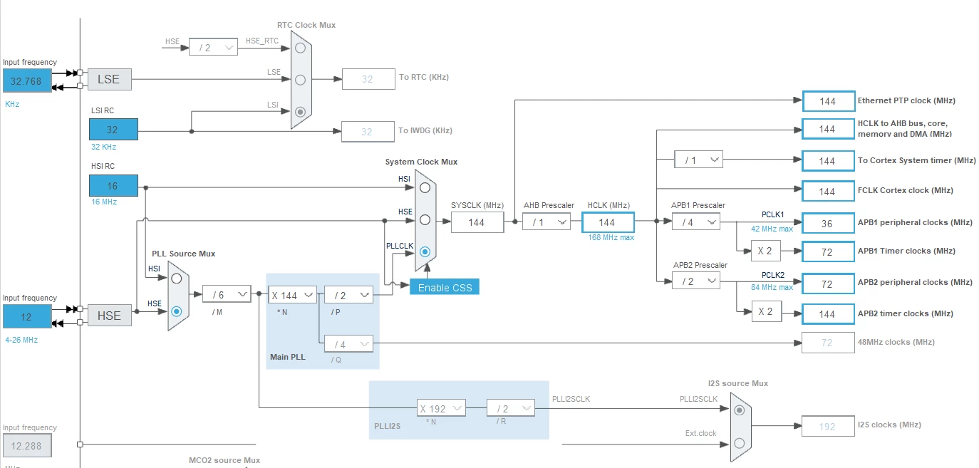

  2. When something goes wrong, the previously working code needs 2 or 3 flashes to complete init again. Mostly the Chip freezes on clock config afterwards.
  3. The Waiting for the ETH_Speed auto negotiation times out the debugger. Reducing the timeout manually is reverted on codegeneration by cube MX
