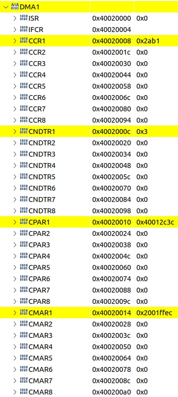

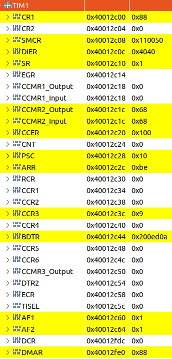

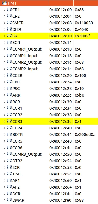

In case I failed to describe any details, I dump the TIM1 register info into files:
  • before_running_TIM20.txt: after setting up TIM1 and enable its DMA1Ch1(no TIM1 PWM output here, as expectedly, since the master-mode TIM20 has not sent out any trigger signal)
  • after_running_TIM20.txt: after running TIM20(I see TIM20 output but no TIM1 output)

Presentation of registers is horrible, how can you make out what happened? Don't you have some means to restrict it only to the relevant registers?
TIM1 SR indicates it has run at least once, if you haven't seen any output pulse, the problem may be GPIO setting so check that. Start with TIM1 running freely (i.e. no slave setting and no OPM), does that produce output PWM signal?
pxia.1
pxia.1Author
Aug 14, 2024 2:42 AM UTC
Hi, JW, thanks a lot for your comment, I put some screenshot of the TIM1 register values, hopefully useful.
The GPIO settings and probing point are confirmed. If I disable TIM1's current setting of slave mode, I can observe the numerically correct PWM waveform as is specified by ARR and CCx settings.
