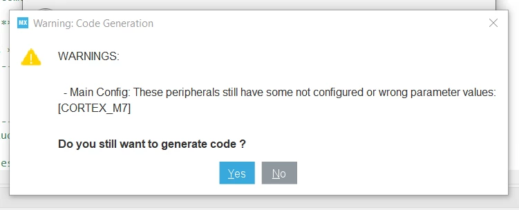

- Main Config: These peripherals still have some not configured or wrong parameter values: [CORTEX M7] getting error
Hello ,
I am working on NUCLEO-H745ziq board. I am trying the example AZURE RTOS of Ux_CDC_device , the example provide in cubemx accordingly I setup the things in cubemx but when I try to generate the code it shows warning and the when I run the programmed hard fault error is come. I follow the example of NUCLEO-H723ZG. all the setup same as I done why Iget these error ? can you please help me

You are probably missing a configuration for some parameters (i.e. if you configure MPU regions, you need to configure all of them, not just some of them).
