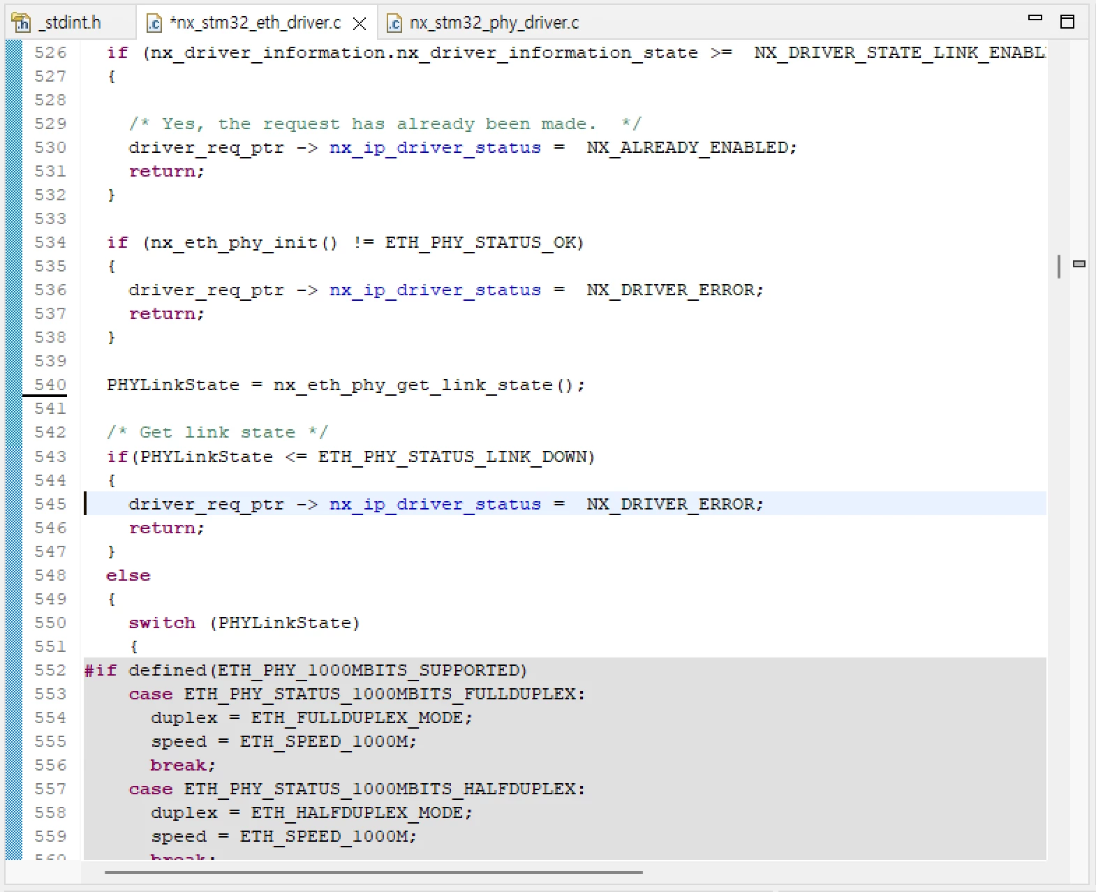

MAC(NetXDuo) is not activated when using MCO1
First of all, NetXDuo is working fine on the NUCLEO-H743ZI board. (PING, UDP, TCP)

X-CUBE-AZRTOS-H7 v3.3.0
I modified it to fit my custom board.
The clock for the PHY chip is different.
It use by MCO1(25MHz) from MCU.

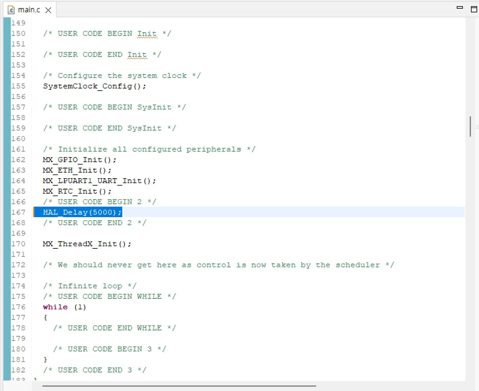

There is failed the _nx_driver_enable() function in nx_stm32_eth_driver.c file.
(PHYLinkState < ETH_PHY_STATUS_LINK_DOWN)
But, if the delay is reflected for more than 5 seconds before PHY initialization, normal operation is achieved.
(PING, UDP, TCP)
The same thing happens if I put a break point at that location in debug mode.
There is no PING response.
