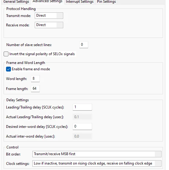

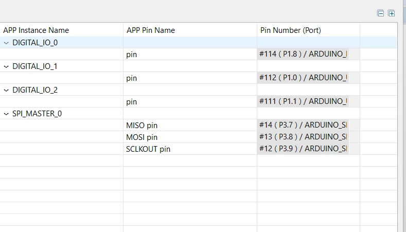

I'm trying to interface M95M04-DR with XMC4700.
When I read RDSR, I receive all 0s.
When I write to an address, again I get all 0s on that address. I'm attaching SPI configuration and code snippet please look help me to solve this issue.
I've connected hold and write protect as high with digital output.
Vcc is 5V.
 uint8_t data_rec[8] = {1, 1, 1, 1, 1, 1, 1, 1};
 uint8_t mem_addr[3] = {0x01, 0x00, 0x00};
 uint8_t data_tr = 0x05;
 DIGITAL_IO_SetOutputHigh(&DIGITAL_IO_0); //CS
 DIGITAL_IO_SetOutputHigh(&DIGITAL_IO_1); //Hold
 DIGITAL_IO_SetOutputHigh(&DIGITAL_IO_2); //Write protect
 //write enable
 DIGITAL_IO_SetOutputLow(&DIGITAL_IO_0);
 SPI_MASTER_Transmit(&SPI_MASTER_0, (uint8_t *)&write_en, 1);
 while(SPI_MASTER_0.runtime->tx_busy);
//some delay
 //write data to address
 SPI_MASTER_Transmit(&SPI_MASTER_0, (uint8_t *)&write_mem, 1);
 SPI_MASTER_Transmit(&SPI_MASTER_0, (uint8_t *)&mem_addr, 3);
 SPI_MASTER_Transmit(&SPI_MASTER_0, (uint8_t *)&data_tr, 1);
 /* Placeholder for user application code. The while loop below can be replaced with user application code. */
 while(1U)
	 if(timer_count > 50)
		 SPI_MASTER_Transmit(&SPI_MASTER_0, (uint8_t *)&read_mem, 1);
		 SPI_MASTER_Receive(&SPI_MASTER_0, (uint8_t *)&data_rec, 8);
//		 SPI_MASTER_Transfer(&SPI_MASTER_0, (uint8_t *)&mem_addr, (uint8_t *)&data_rec, 3);
		 timer_count = 0;
