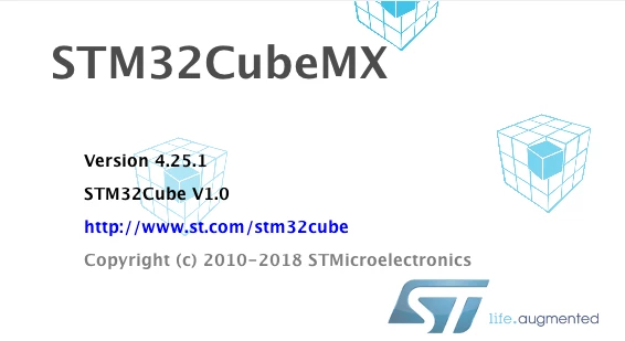

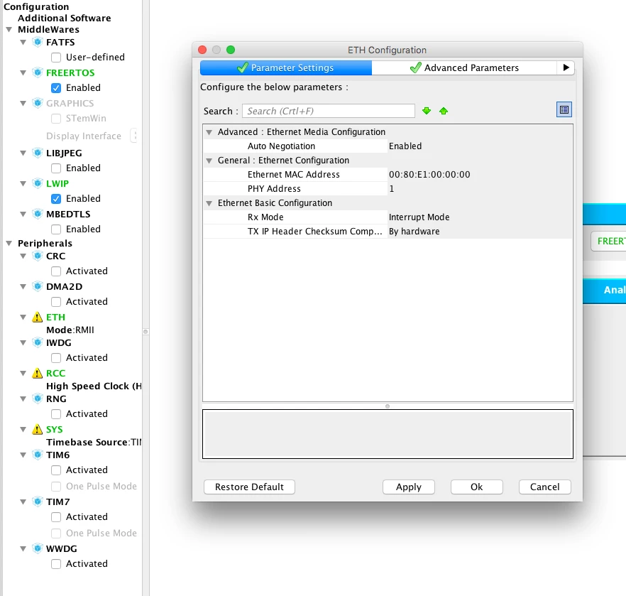

john doe
Senior III
May 23, 2018 1:37 PM UTC
Posted on May 23, 2018 at 13:37
It is NOT fixed in 4.25.1. PHY defaults to 1 - see attached images

iw2lsi
Mar 11, 2020 1:53 PM UTC
As far I can see, initially CubeMX starts with the correct PHY address of 0... but then if you (for example) disable and re-enable the ETH device, it changes the PHY address from 0 to 1
We are spending so much time on this stupid CubeMX behaviours...
