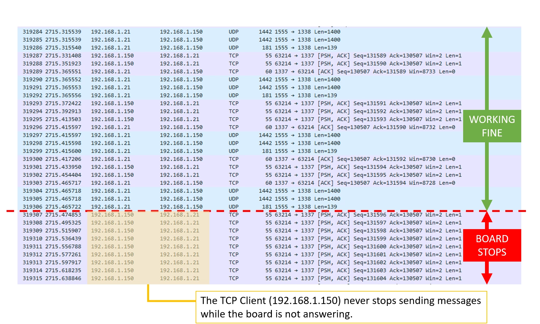

I'm developing an ethernet application on a NUCLEO-F746ZG board using the LWIP library. My app basically consists of the board (ip:192.168.1.21) is receiving a message every 20ms form a TCP client (my PC ip: 192.168.1.150) while the board sends UDP messages to another UDP server. All works fine until it reaches 1 hour since I started the connection with the TCP server of the board.
I´ve analyzed the network traffic and what I can see form Wireshark is that the NUCLEO suddenly stops responding messages, so the client aborts the connection few minutes after with the board few minutes after, as you can see at the photo. This happens 48/52 minutes after the first TCP message is received by the board. 0690X000008i5uZQAQ.png
*If I don’t start the TCP server UDP Client never stops sending messages, so I suppose the problem is from the TCP server.

If anyone knows why its that happening please answare this question, :folded_hands: :revolving_hearts:
Thanks in advance.
