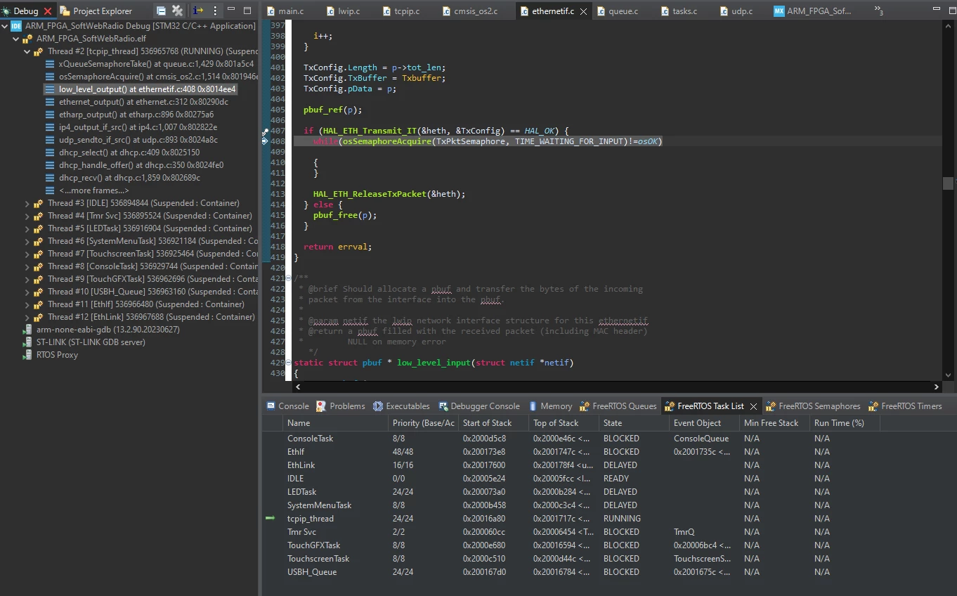

Hi, i have STM32F767 and im using FreeRTOS V2 and lwIP. Im facing known bug which should be fixed in FW_F7 V1.17 and im using FW_F7 V1.17.2 and still facing this.
When i connect the ethernet cable, after 2 seconds FW is stuck at following place:
I tried to disable DHCP everyting is ok, but when i try to ping the board the result is the same.

Hello @Petr3,
are you sure you are using the latest version of CubeFirmware as you can see that this fix is available on GitHub
Release v1.17.2 · STMicroelectronics/STM32CubeF7@767d083

the fix is related to LWIP application and not Ethernet and it is present in V1.17.2 and here are the changes:
  • LwIP Applications
    • Use RCC_HSE_BYPASS value in SystemClock_Config() API for NUCLEO-F767ZI related projects, and adjust PLL parameters when needed, to comply to technical documentation.
    • Fix Wrong use of DHCP API in application code & ethernet_link_thread.
    • Fix Ethernet low_level_init() API to handle return code from LAN8742_init() and DP83848_init() APIs.
    • Fix mismatch in linker section names between linker file and source file.
    • Fix DeadLock in the transmit output.
    • Adjust iPerf bandwidth higher than 90Mbs.

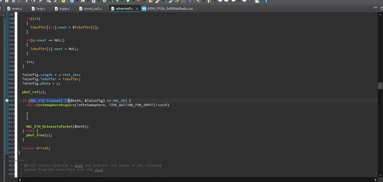

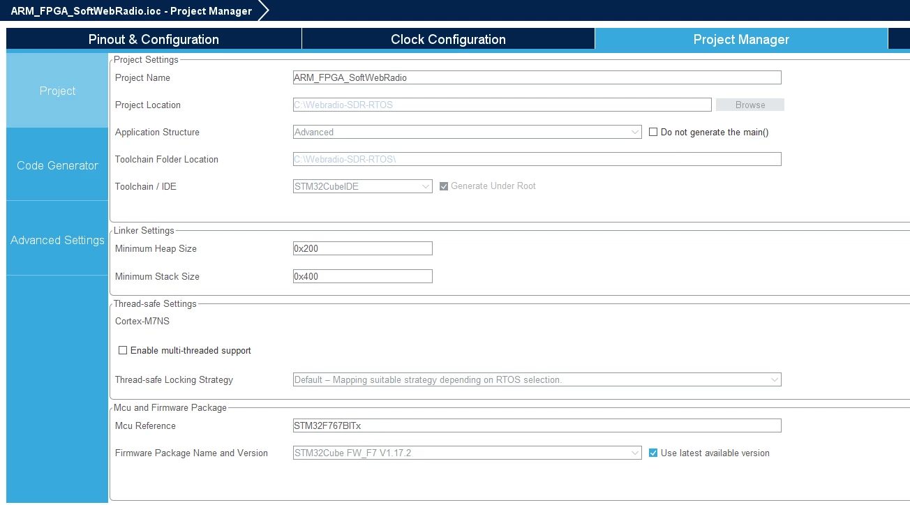

Hello STea,
i hope im using latest version of FW pack:
 but the lwIP code seems to be different:
where i can update lwIP for latest version? I thought it is part of FW pack for F7 family.

Hello @Petr3 ,
you are right, the generated code with MX is generated with the old Ethernetif.c template I'm able to reproduce this and I reported it internally (ticket number 194996 internal reference only) for investigation
in the meanwhile, I suggest you make those changes to your code manually and you should be good to go.
