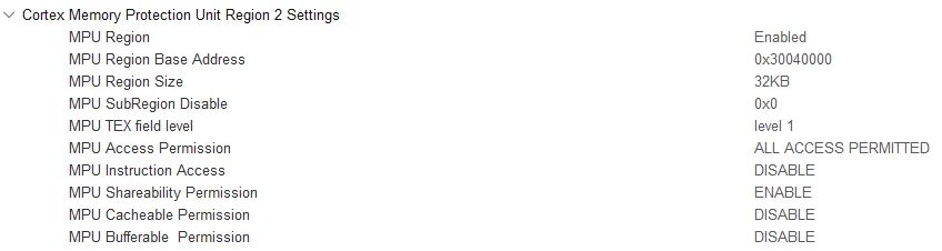

To fix the hard fault, I shall modify the MPU configuration: basically in the ST guide (https://community.st.com/t5/stm32-mcus/how-to-create-project-for-stm32h7-with-ethernet-and-lwip-stack/ta-p/49308 ) the memory region deicated to the ETH descriptors was limited the the descriptors only and was defined as shared-device region.
I just extended the region to the .Rx_PoolSection and defined it as Normal-Non Cacheable reagion as follow...
This configuration could be considered a valid solution ot it would be better add a further region dedicated to the descriptors?

Their article doesn't configure the Rx pool memory region in MPU because the code kind of uses the D-cache maintenance functions. I am saying "kind of", because that code is incomplete and therefore flawed. Making that region normal non-cacheable solves the caching issues, but decreases the performance significantly. Previously the descriptor memory region required to be configured as a device or strongly-ordered memory type, but, as the reworked drivers now use memory barrier instructions, making it normal non-cacheable is enough. By the way, MPU regions can be overlapped and overlayed - the higher numbered region takes the charge.
