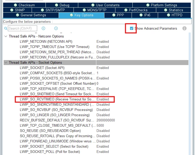

Hi guys,
I’m using lwip libray with netconn api on stm32h7, I want to enable the receive timeout using netconn_set_recvtimeout method. In order to do that LWIP_SO_RECVTIMEO macro should be set to 1 (default value is 0). There is no LWIP_SO_RECVTIMEO macro in the LWIP section of the .ioc file.
How can I configure it ? Shoudl I set another macro in the .ioc or should I change LWIP_SO_RECVTIMEO value in the header file ?
1 reply
Jul 9, 2026 11:02 UTC
Hello ​@bsp,
Thank you for your report.
You can enable LWIP_SO_RCVTIMEO in CubeMX by checking “Show Advanced Parameters”.
Then, you will find this option under Thread Safe APIs → Socket Options.
