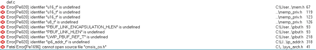

I've been trying to write my own HAL to replace the STM32 HAL and recently I have been trying to write an LwIP interface, with guidance from this forum and the examples provided by ST and other users.
My Individual files compile fine, including my ethernetif.c and lwip.c files.
The included LwIP library files however are throwing errors during compilation (see screenshots).
Can anyone advise?
When I compare to a Cube generated project, my IAR is including extra header files, such as bpstruct.h as shown below. I'm wondering if this is a project configuration error, as opposed to a source code error?
Grateful for any comments.

Update:
After picking through the project I've found removing the inclusion of my version of lwip.h from main.h and then calling it after in main.c has solved the errors.
I must have some sort of "code smell" in my project which is currently undiagnosed. Most of my files point to main.h.

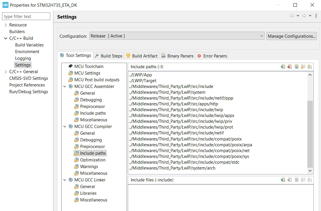

I somehow remember I once had some of the error messages, like PBUF_*, but I can't remember how I solved this.
Anyway, I'm using STM32CubeIDE only...
But you are definitely missing the lwIP types like u16_t, I would look for these first.
Here's what's included via the project settings:

Thanks @LCE for the reply.
I've checked those project locations and they are the same as mine.
I've even taken a cube project and then copied my files in, keeping LWIP files where they are, and then removed the cube files.
These are my include paths from my .ewp file:
