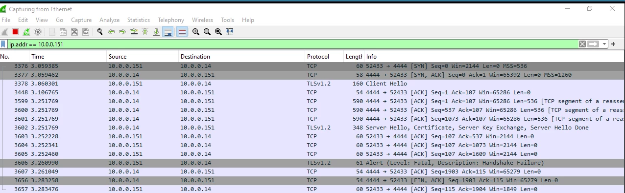

LWIP MBEDTLS, no RTOS
I have tried to get LWIP and MBEDTLS working in RAW mode without an RTOS but have failed miserably...
I think I have overlooked something - any suggestions?
The failure is at -
ssl_tls.c - line 2629
if( ! mbedtls_pk_can_do( &ssl->session_negotiate->peer_cert->pk, pk_alg ) )
   MBEDTLS_SSL_DEBUG_MSG( 1, ( "bad server key exchange message" ) );
   mbedtls_ssl_send_alert_message( ssl, MBEDTLS_SSL_ALERT_LEVEL_FATAL,
                                           MBEDTLS_SSL_ALERT_MSG_HANDSHAKE_FAILURE );
   return( MBEDTLS_ERR_SSL_PK_TYPE_MISMATCH );
My server shows -

And the Wireshark screenshot attached shows the cert has been uploaded but probably nothing done with it.
The attached TLS Code file shows what I have done to try to make it work.

Visitor II
Sep 18, 2023 4:36 PM UTC
I think I am heading down thw same rabbit hole, did you ever sole it?
