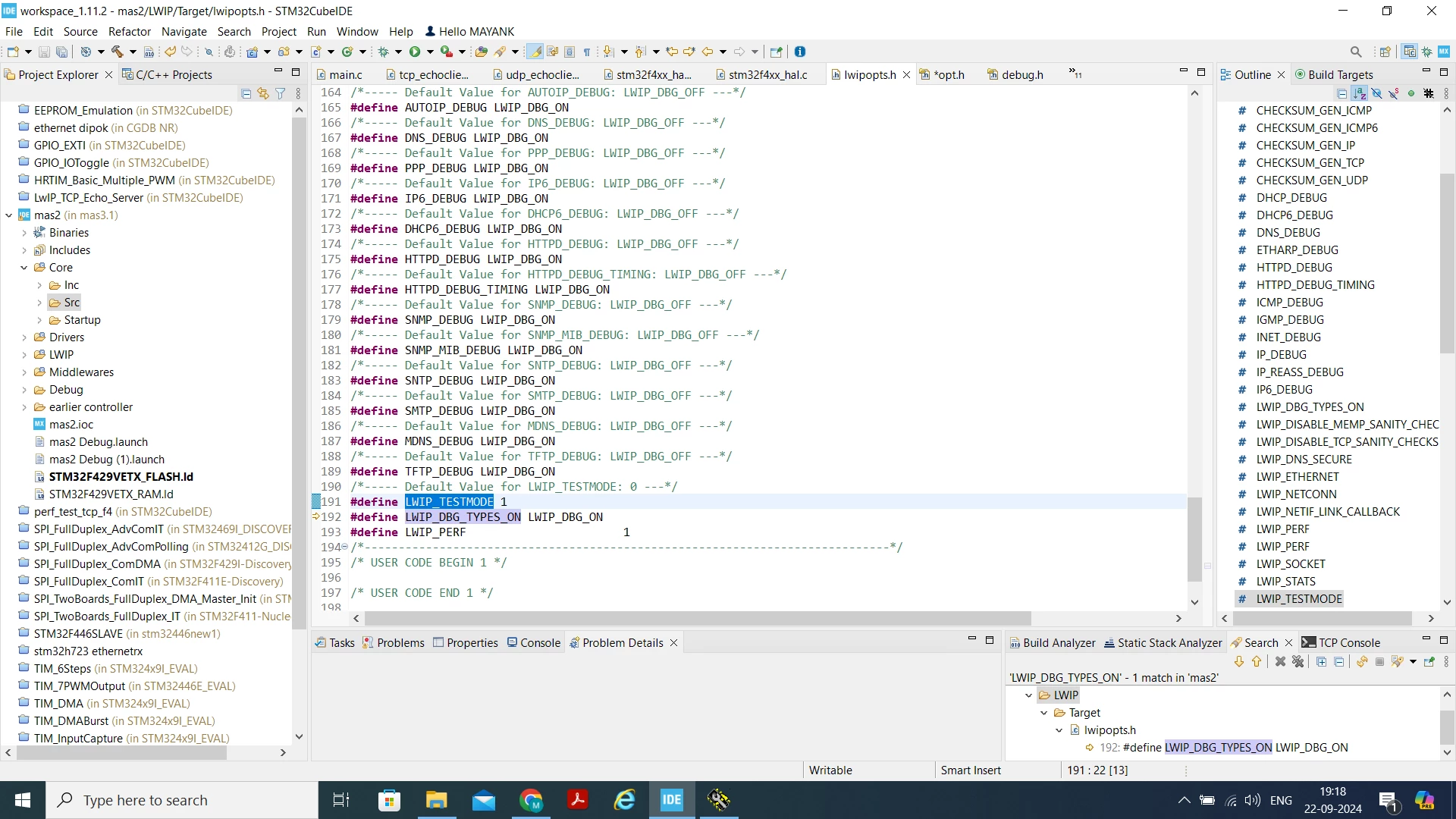

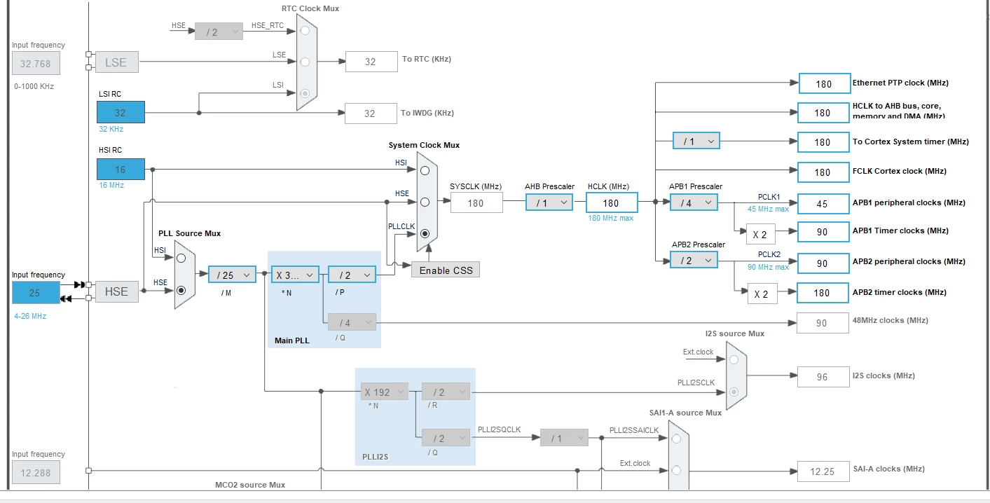

HI
I HAVE ENABLED LOG LIKE THIS
WHAT ELSE NEEDS TO BE DONE I HAVE SEEN OLD POST TO WRITE MAIN.C
BUT STILL NOT SHOWING LOG?
LWIP LOG WILL BE VISIBLE IN CONSOLE OR SWV CONSOLE WHERE?
THANKS IN ADVANCE

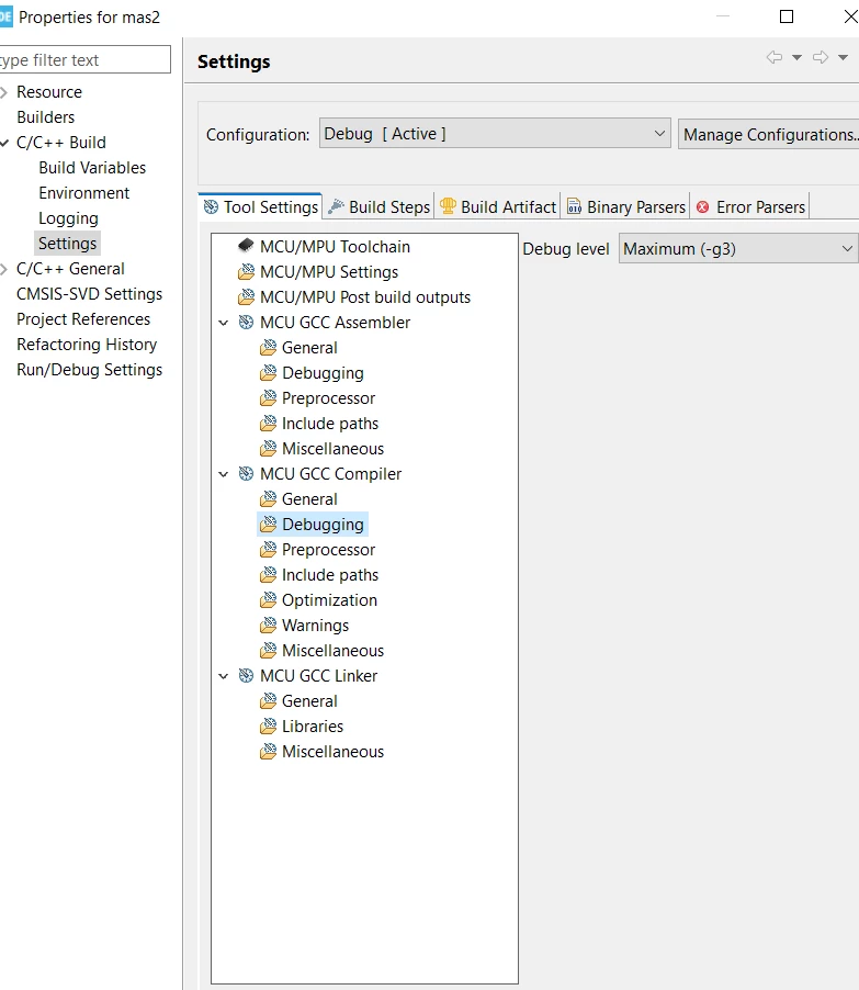

Sep 23, 2024 3:36 PM UTC
Hello @MGOEL.1 ,

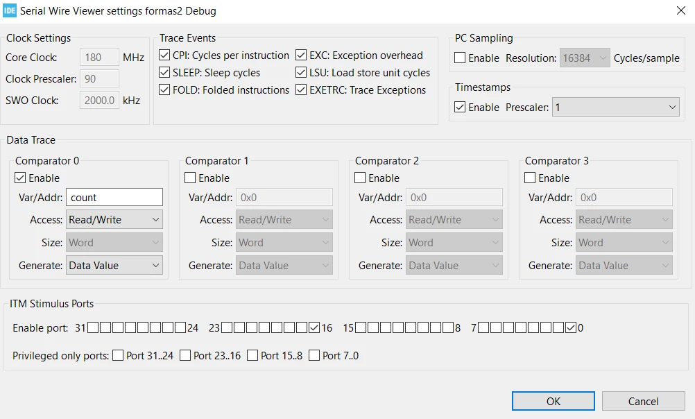

the output of the log as I see in the redefinition of the write function will be redirected to the itm console.
you need to first enable the swv feature in debug configuration setting the clock frequency and the open the port associated with the redirected print
here is a code tetorial showing how to do it
Using Printf Debugging, LIVE expressions and SWV Trace in CubeIDE || STM32 || ITM || SWV (youtube.com)
Regards
MGOEL.1
MGOEL.1Author
Sep 24, 2024 11:53 AM UTC

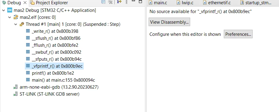

@STea thanks for video but i am getting error No source available for "_write _r() at 0x8010be0" i  have checked in debugging as per others errors still it is not printing on s w v port
print f  ("test= %d \n", count);
count++;
fflush(stdout);
thanks in advance

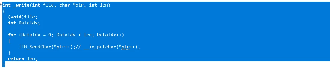

Sep 24, 2024 1:31 PM UTC

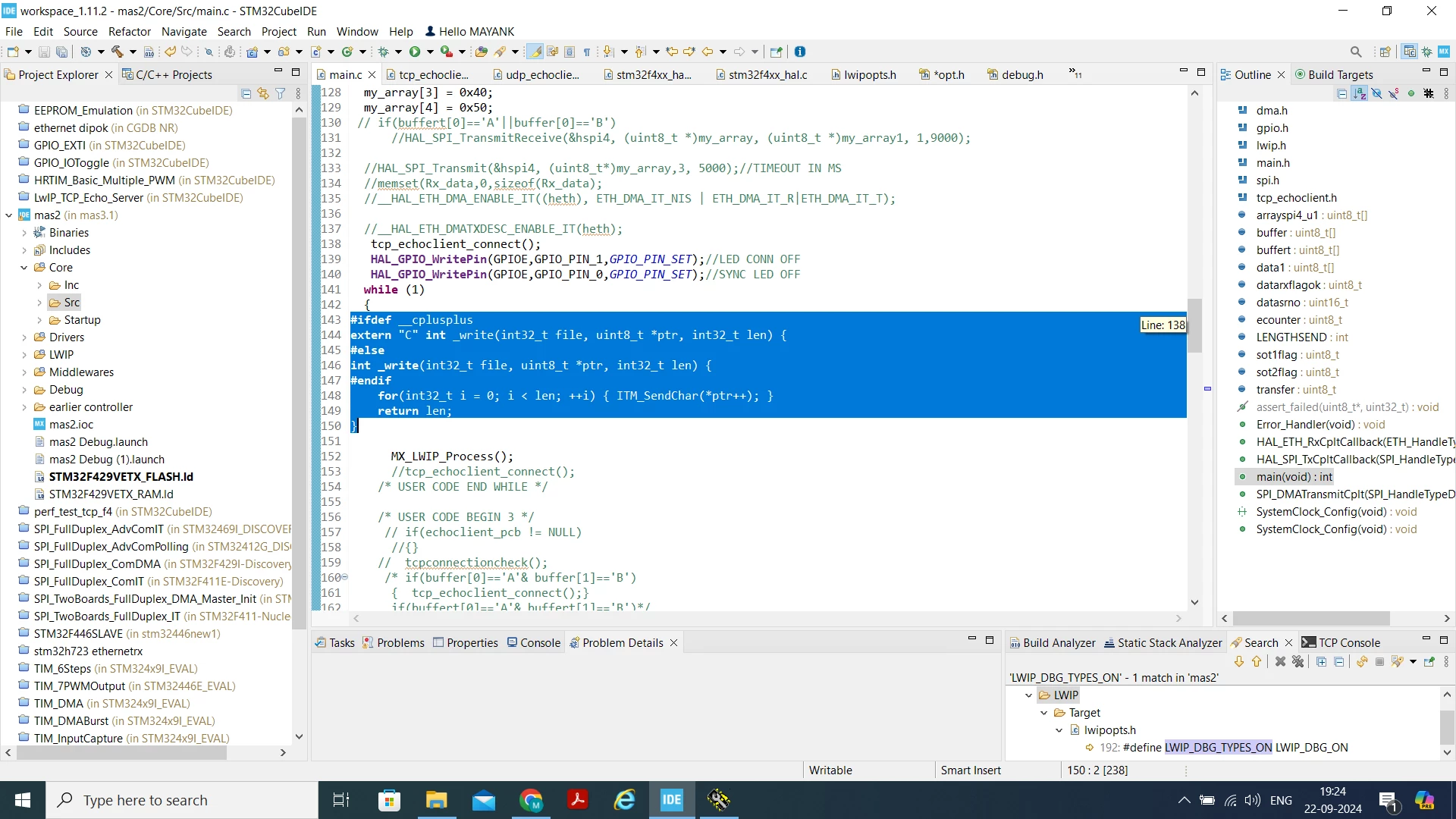

Hello @MGOEL.1 ,
you should add this in you main.c file
/* USER CODE BEGIN 4 */
int _write(int file, char *ptr, int len)
 (void)file;
 int DataIdx;
 for (DataIdx = 0; DataIdx < len; DataIdx++)
 { //To get printf working using serial wire viewer (available on cubeIDE only)
	 ITM_SendChar(*ptr++);
 return len;
/* USER CODE END 4 */
without any ioputchar prototype needed
if you still experiencing issue, send you main.c file to take a look.
Regards
MGOEL.1
MGOEL.1Author
Sep 25, 2024 3:00 AM UTC
@STea i have written in main still getting same error
i have attached main file .Not able to understand this error
