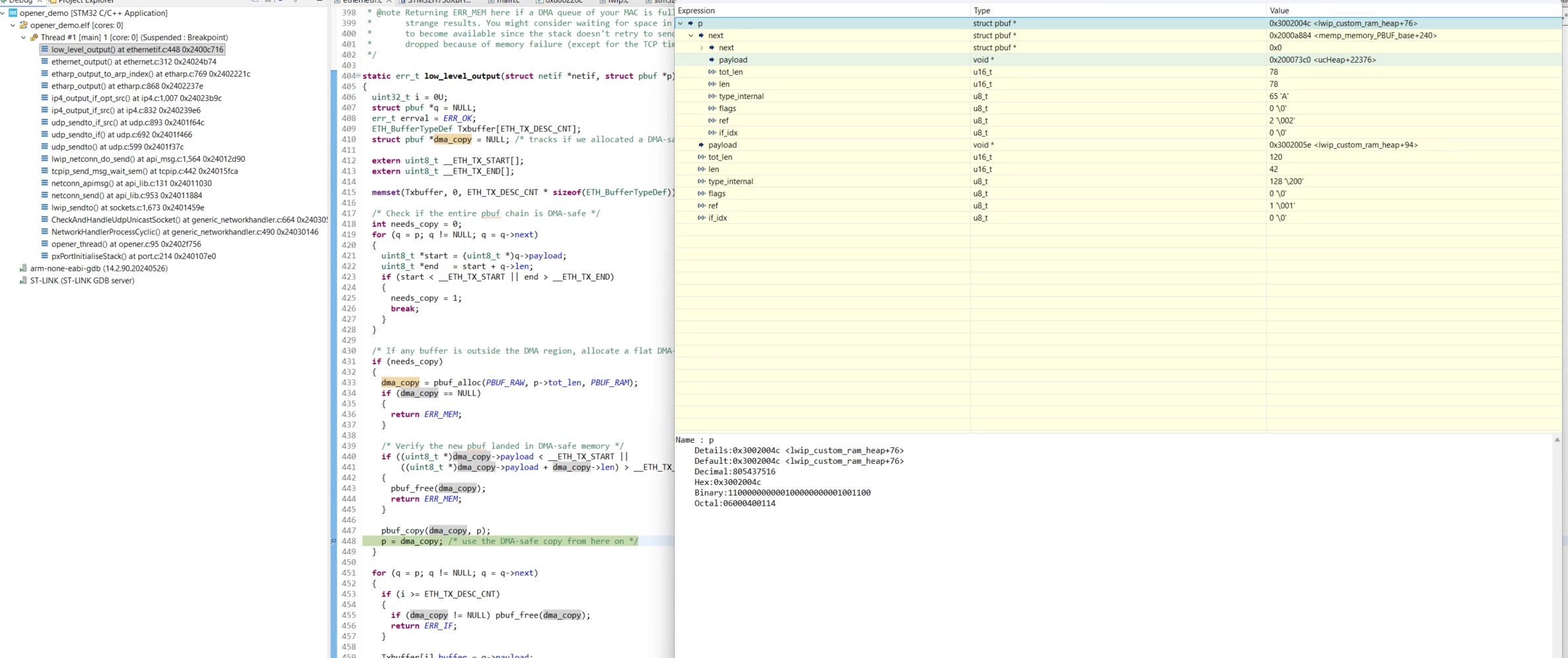

I have followed the instructions in GIT  to make ethernet works correctly on STM32H750 (setup TX/RX descriptors and their MPU config, also the LWIP heap and its MPU config, and the RX buffers).
Everything seems working correctly after hours of setup and debugging, but the thing that break Ethernet and make it not working is when handling the unicast UDP or the UDP IO stream of OpEner it trigger a BUS Error in MAC DMA and stop everything from working, the explicit communication based on TCP works correctly and doesn’t break the Ethernet.

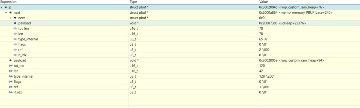

I debugged for days of what could generate a bus fault error, then i find the udp when uses netconn it doesn’t copy the prepared buffer on lwip heap for sendig and in other way it give it directly the address of udp payload from the task stack, and this trigger a Bus Error when calling HAL_ETH_Transmit_IT because the task stack is not DMA accessible.

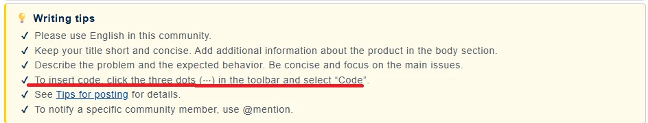

Hello ​@ALAMI_Othmane ,
While starting this thread did you notice this pop-up and read its content?
Jul 7, 2026 10:12 UTC
Hi @mƎALLEm, sorry I forgot to include the code inside the code section.
Can you confirm that the low_level_output function generated by CubeMX is triggering issues with UDP communications?

Yeah it’s strange also for me to see lwip use the c heap( which is placed inside DTCMRAM which is forbidden from Ethernet IP)  instead of LWIP_RAM_HEAP_POINTER in some specific udp transmissions, like this:
Maybe if I move the heap location to AXI RAM will solve the issue, but I still don’t understand why the lwip uses the c heap instead of its own heap.

Jul 9, 2026 14:17 UTC
After some research with our AI friends:
For UDP socket send() and sendto(), if LWIP_NETIF_TX_SINGLE_PBUF is disabled, lwip uses netbuf_ref() at sockets.c:1701, which creates a PBUF_REF in netbuf.c:151. Payload points to your application buffer, so no payload copy to lwip heap.
if option LWIP_NETIF_TX_SINGLE_PBUF is enabled, netbuf_alloc() is used and the data is copied in the allocated buffer.
Another possible solution if you want to keep LWIP_NETIF_TX_SINGLE_PBUF disabled and use socket sendto() for UDP packets would be to allocate buffers in AXI or AHB SRAM that is accessible by Ethernet and pass them to lwip sendto(). Preferably buffers in memory area declared as non cacheable strongly ordered with the MPU like it is done for the custom RX_POOL pbuf pool.
For TCP sockets I guess there is always a copy so no problem.
