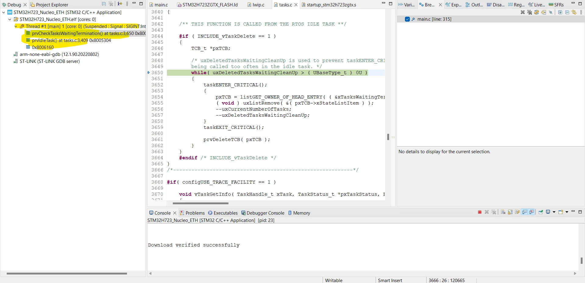

Oct 8, 2024 2:45 AM UTC
I'm also having this issue with my STM32H725ZGT6, but not my STM32H723 Nucleo board, does anyone have any updates on this issue?

Oct 28, 2024 1:38 AM UTC
Sorry for the delayed response, it turned out to simply be not giving the default task enough memory. 512+ Words seems to be needed.
