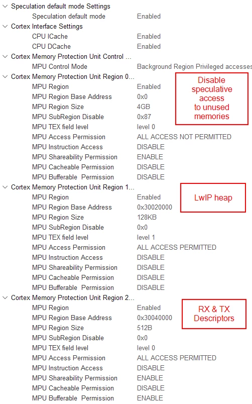

Feb 12, 2024 10:26 AM UTC
Hello @hzoli and welcome to the Community :),
I recommend you to take a look at How to create project for STM32H7 with Ethernet an... - STMicroelectronics Community and at STM32H747_Disco_M7_ETH example may help you. The Dcache is enabled in these examples.
Also, I advise you to check the MPU configuration.
Pease note that, if the cache is enabled, it is requires to follow this order: configure MPU firstly, then enable cache.
 /* MPU Configuration--------------------------------------------------------*/
 MPU_Config();
 /* Enable I-Cache---------------------------------------------------------*/
 SCB_EnableICache();
 /* Enable D-Cache---------------------------------------------------------*/
 SCB_EnableDCache();
Thank you.

mƎALLEm
Feb 12, 2024 11:50 AM UTC
You need to disable the cache for Rx and Tx ETH descriptors and LWIP heap using MPU. You have a data coherency issue:
So as said by @KDJEM.1 , refer to the link https://community.st.com/t5/stm32-mcus/how-to-create-project-for-stm32h7-with-ethernet-and-lwip-stack/ta-p/49308
Also please refer to the AN4839 "Level 1 cache on STM32F7 Series and STM32H7 Series" for cache usage and mistakes to avoid.
hzoliAuthor
Feb 13, 2024 6:41 AM UTC
Thank you all! After I configured the MPU, the LWIP heap address and modified the linker script, now working perfectly.
@mƎALLEm Thank you for the tip and the documentation link about "Level 1 cache".
