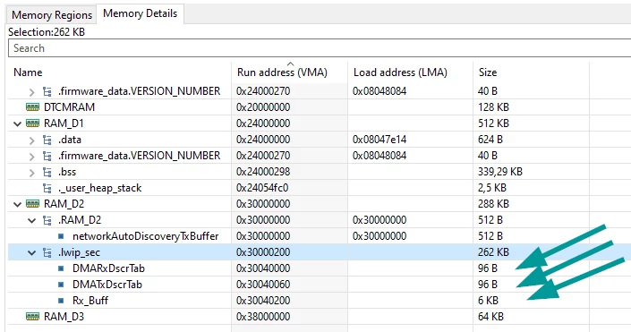

0693W00000D0hLKQAZ.pngWhen I check the Memory Details, I see that there are only the assigned descriptors inside and the 6k for the RxBuffer. There is also 512B for an internal buffer I need.

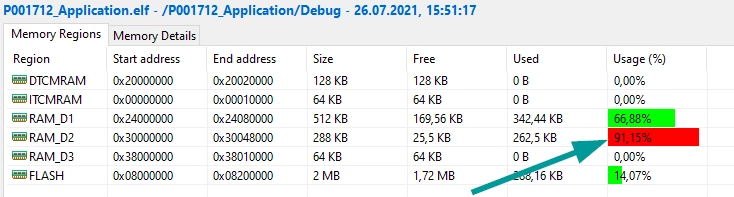

0693W00000D0hMqQAJ.pngBut why is the build analyzer showing that the RAM D2 is almost full?

sorry I forgot to add the part of the linker script. Please see the modifications in the linker script below:
 /* Modification start */
 .lwip_sec (NOLOAD) : {
 . = ABSOLUTE(0x30040000);
 *(.RxDecripSection)
 . = ABSOLUTE(0x30040060);
 *(.TxDecripSection)
 . = ABSOLUTE(0x30040200);
 *(.RxArraySection)
 } >RAM_D2
 /* Modification end */
DWeb_2
Jul 27, 2021 7:11 AM UTC
Your LwIP section begins right after the D2 RAM (is automatically placed there) . You can change the start of the section in the linker script to an absolute address. Keep in mind to include the LwIP heap.

Try this snippet for the linker script:
.lwip_sec 0x30040000 (NOLOAD) :
I can't help you considering the LwIP config
