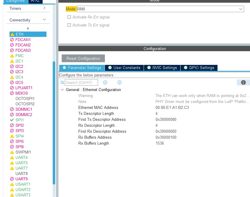

Hi ST Community,
I am working on a project using the STM32H723 MCU and the KSZ8863 Ethernet switch. I initially encountered issues while using a modified TCP echo server example, but after reverting to the unmodified example, the same issue persists. Communication is functional, but the system eventually crashes with the following assertion:
Assertion "mem_free: illegal memory: non-linked: double free" failed at line 661 in ../Middlewares/Third_Party/LwIP/src/core/mem.c
System Details:
  1. MCU: STM32H723
  2. Switch: KSZ8863 (connected via RMII for Ethernet data and SPI for control)
  3. Middleware: LwIP (as provided in STM32Cube firmware package)
  4. Example Used: Modified tcpecho server example from LwIP.
  5. Peripheral Interface:
    • RMII for Ethernet data.
    • SPI for KSZ8863 switch configuration.
    • SMI is not used.
Observed Behavior:
  • The application works correctly for some time, and the TCP echo functionality responds as expected.
  • Under moderate network load or over time, the system crashes with the above assertion in LwIP’s mem_free function.

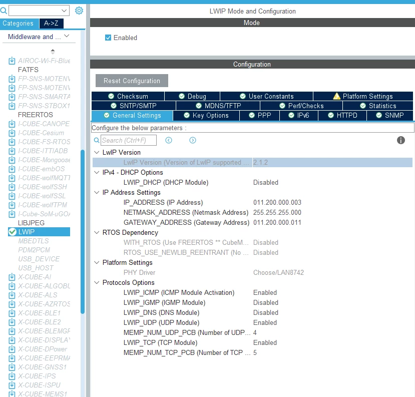

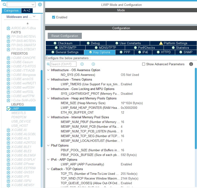

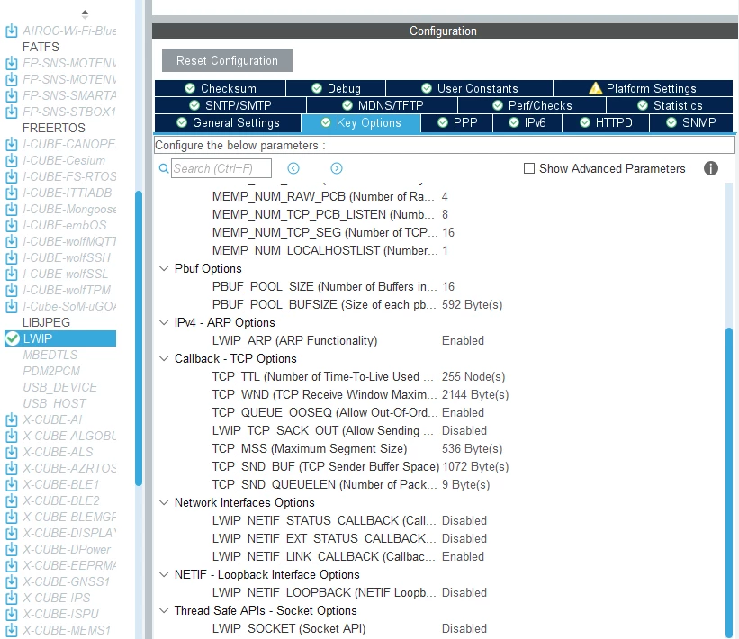

Here are the configurations:
Cortex M7:
Ethernet:
LwIP:
Thanks in advance for any guidance!

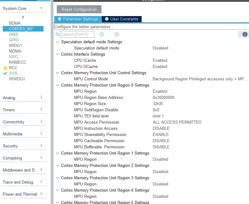

Hello @wsrrasel ,
Your memory configuration is lacking and don't cover parts where LwIP heap and descriptors will be placed.
You need to take care when allocating memory make sure you have the permission in MPU configuration for that address range and calculate the amount of allocated Heap according to the available memory on your case the SRAM.
Also, you will need to handle the freeing of allocated memory when not used to make sure you don't run out of usable memory.
