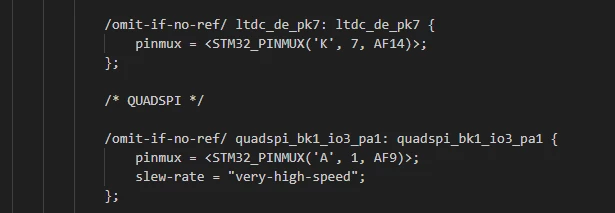

While looking at the stm32h745xihx-pinctrl.dtsi file I see the slew rate is defined for the QUADSPI pins, but the LTDC pins. Is it set to Very High speed implicitly? I would be concerned if they are set to Low Speed by default.
Thanks in advance for any input.

Hello @xavierpacheco-eaton,
According to the STM32H745 datasheet, in the LTDC paragraph, the output speed is OSPEEDRy[1:0] = 11, which corresponds to very-high-speed configuration, and the high LTDC clock output frequency (up to 150 MHz), so, the slew rate needs to be set appropriately explicitly to handle these high-speed signals and to avoid concerns about the default configuration potentially being set to a lower speed.
/omit-if-no-ref/ ltdc_de_pk7: ltdc_de_pk7 {
 pinmux = <STM32_PINMUX('K', 7, AF14)>;
 slew-rate = "very-high-speed"; // Explicitly setting the slew rate
 Hope that answers your question!
