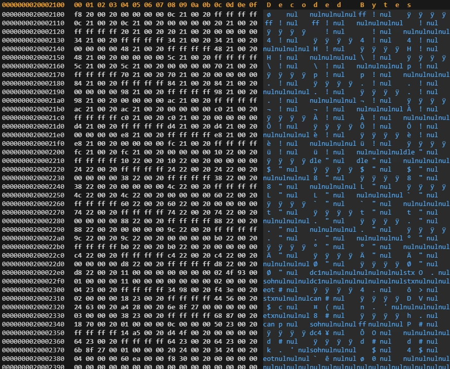

I want to explain better the application:
A middle priority task is continuously notified by an ISR (relative to an EXTI interrupt) and fill a FreeRTOS queue with some values read from spi peripheral (frequency goes from 2.5 Hz to 40Hz). A low priority task will consume this data, waiting on queue. An higher priority task is notified by the ISR inside critical section as described before, with a periodicity of 10 minutes.
Rest of the time microcontroller goes to low power mode (stop2 specifically).
Next are the results of various tests done:
  • Installed last version of FreeRTOS kernel: problem persists
  • Disabled tickless idle: problem does not appear
  • When problem comes, xTickCount stop to be incremented because scheduler remains suspended (uxSchedulerSuspended = 1)
  • When problem comes those are the values of some kernel variables:
RAM Address| Object | Value |
0x200022e4 | volatile UBaseType_t uxCurrentNumberOfTasks | 0x11 |
0x20002370 | volatile TickType_t xTickCount | 0x278f6b |
0x200022f8 | volatile UBaseType_t uxTopReadyPriority | 0x0 |
0x20002344 | volatile BaseType_t xSchedulerRunning | 0x1 |
0x200022ec | volatile UBaseType_t uxPendedTicks | 0x934f02 |
0x20002374 | volatile BaseType_t xYieldPending | 0x1 |
0x2000232c | volatile BaseType_t xNumOfOverflows | 0x0 |
0x200022f4 | UBaseType_t uxTaskNumber | 0x11 |
0x20002328 | volatile TickType_t xNextTaskUnblockTime | 0x278f6e |
0x20002324 | TaskHandle_t xIdleTaskHandle | 0x200028a4 (Idle_TCB) |
0x200022f0 | volatile UBaseType_t uxSchedulerSuspended | 0x1 |
 And this is a partial dump of RAM:
Tickless mode uses the default implementation from port.c but the pre/post sleep hooks are installed and implemented by ST. Inside the pre/post hooks some peripherals clock are disabled by me.
From FreeRTOS community the PreSleepProcessing() and PostSleepProcessing() functions seem to be the cause of the issue; they say that I'm not supposed to manipulate the SysTick timer in those functions as I might break the careful logic in vPortSuppressTicksAndSleep(). However, it seems strange to me that the error is coming from those two functions considering that being written by ST I imagine that they were verified.
I cannot attach the full .ioc file here, but I can attach a part of it. Tell me which parts can be useful
