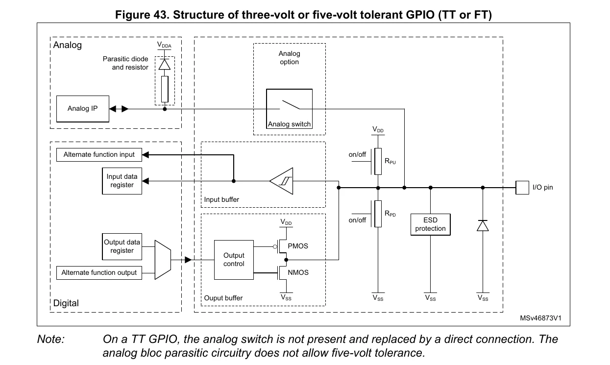

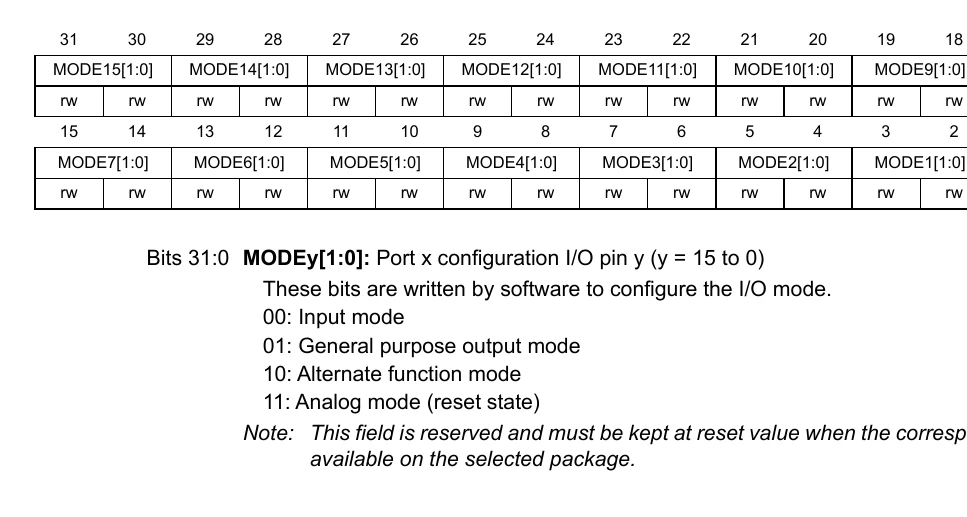

AScha.3
Jan 27, 2025 9:06 AM UTC
see in rm U5xx :
port registers :
For uart rx/tx you need AF setting. But you cannot choose more than ONE mode for a pin.
You haveto  set it to AF , uart working then.
...and try, to read the input state from input register - should be still connected, if this pic is correct:
Just try... (i never tried and have no U5...) .If there is an input mux , not shown in pic, then its not possible.

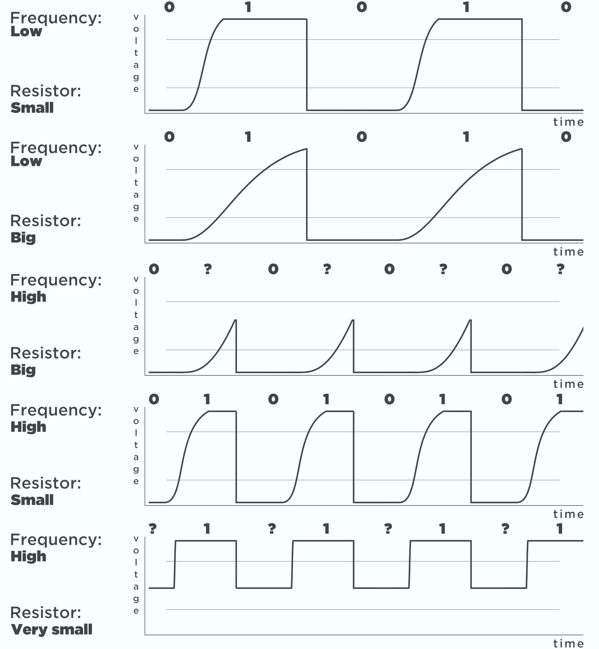

Andrew Neil
Jan 27, 2025 9:23 AM UTC
@Meghana wrote:
Transmission works fine
How have you verified that?
Any open-drain (or open-collector) output will always require a pullup to work - it's basic electronics.
An open-drain output acts as just a switch to ground: it can pull down, but it can never drive high - hence a pullup is always essential.
Internal pullups have a fairly high resistance - around 40k ? - so are not going to be suitable for high-speed comms.
This post shows the effect of pullup value on the communication:
So use an oscilloscope to check what's happening in your case ...
