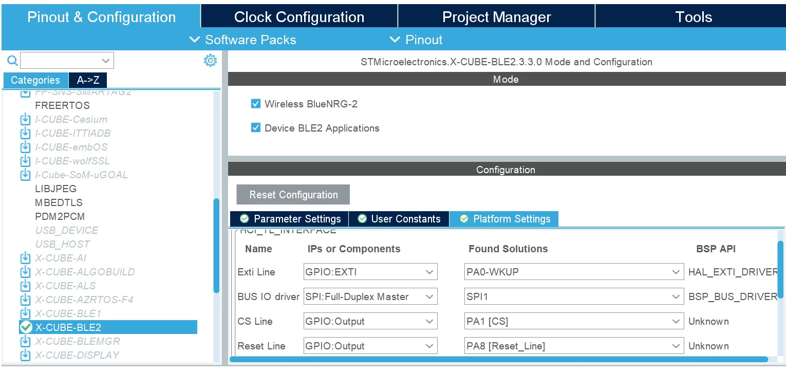

Looking for drivers files related to BLE module for BlueNRG-M2SA
Hi Team,
Where can I find the driver's files related to BLE module for BlueNRG-M2SA?
we are using STM32L475RGT6 MCU to communicate wirelessly using the mentioned Bluetooth module.
Kindly help me on this.
Thanks
    1 reply
    AElgh
    Feb 11, 2024 12:20 PM UTC
    If you're using CubeIDE, you can install the X-Cube-BLE2 Package which includes examples that drive the Module
    or you can download the package manually from here.
