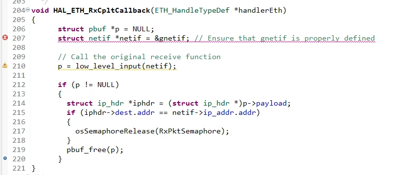

Without checking the IP address, semaphores may be released for packets that are not destined for the specific node. To avoid this, you can use the ip_hdr structure to manually check the destination IP address. Here's an example that might help
void HAL_ETH_RxCpltCallback(ETH_HandleTypeDef *handlerEth)
 struct pbuf *p = NULL;
 struct netif *netif = &gnetif; // Ensure that gnetif is properly defined
 // Call the original receive function
 p = low_level_input(netif);
 if (p != NULL)
 struct ip_hdr *iphdr = (struct ip_hdr *)p->payload;
 if (iphdr->dest.addr == netif->ip_addr.addr)
 osSemaphoreRelease(RxPktSemaphore);
 pbuf_free(p);
You can refer to the LwIP examples provided in the STM32CubeH7 package as a starting point: STM32CubeH7/Projects/NUCLEO-H723ZG/Applications/LwIP at master · STMicroelectronics/STM32CubeH7 (github.com)

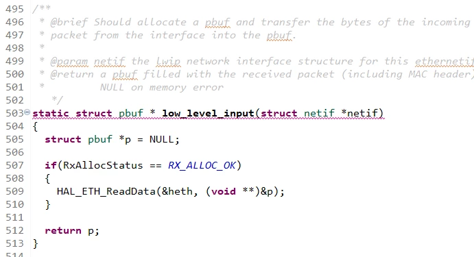

I ve added your code to my void HAL_ETH_RxCpltCallback(ETH_HandleTypeDef *handlerEth) function in the ethernetif.c file but i got errors after compiled. Where am i wrong ?
Thanks
ethernetif.c:207:34: error: 'gnetif' undeclared (first use in this function); did you mean 'netif'?
ethernetif.c:503:22: error: conflicting types for 'low_level_input'; have 'struct pbuf *(struct netif *)'
static struct pbuf * low_level_input(struct netif *netif)
and
Sep 9, 2024 4:07 PM UTC
You are missing the declaration of gnetif. Please ensure that gnetif is properly declared as follows:
extern struct netif gnetif;
"If your question is answered, please close this topic by clicking ""Accept as Solution""."
