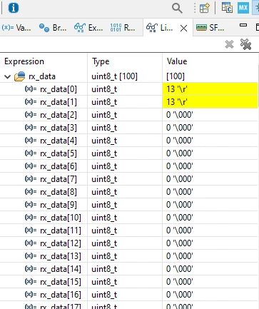

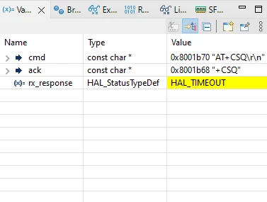

Hi Community,
I am trying to integrate SIM800L module with STM32F103C6T6 using UART (POLL method), code given below, but all I am getting a response is a single char 'A' or sometimes a random value as shown in screenshots.
I have also tried setting up the Baud rate at 9600. But no luck, everytime I am getting the HAL_TIMEOUT error message with buffer sometimes a single digit character 'A' or some values from command itself populated in the response buffer.
Also, I have tried with Putty and it works fine, I get the complete response for a given AT command as expected from manual

waclawek.jan
Feb 15, 2024 5:15 PM UTC
The module may echo back what you've sent, as you send the characters; and if you don't read out from UART the characters sent back during transmission, the receiver overflows and stops receiving further characters. So you really may need a duplex (RxTx) process in place. Best, don't use Cube/HAL functions, write your own.

Andrew Neil
Feb 16, 2024 10:45 AM UTC
@veeshaljha wrote:
POLL method
Maybe you are not polling fast enough?
This seems flawed:
HAL_StatusTypeDef rx_response = HAL_UART_Receive(&huart1, rx_data,
				strlen(ack), timeout_tx_rx);
How do you know exactly what the length of the response will be before it's  arrived?
Are you sure you've correctly accounted for all formatting characters - CR, LF, etc ?
Your code only looks at the expected responses:
	SendAtCmd("AT\r\n", AT_OK_RESPONSE);
	SendAtCmd("AT+CSQ\r\n", "+CSQ");
	SendAtCmd("AT+CREG?\r\n", "+CREG");
	// GPRS init
	SendAtCmd("AT+SAPBR=3,1,\"Contype\",\"GPRS\"\r\n", AT_OK_RESPONSE);
	SendAtCmd("AT+SAPBR=3,1,\"APN\",\"airtelgprs.com\"\r\n", AT_OK_RESPONSE);
	SendAtCmd("AT+SAPBR=1,1\r\n", AT_OK_RESPONSE);
You have nothing to deal with any unexpected responses!
Mobile networks are inherently unreliable - you need to be able to cope with failures & unexpected responses!
Also this would require that all unsolicited responses are disabled.
Also:
Note that the correct terminator for AT commands is just CR - no LF is needed.
The extra spurious LF shouldn't hurt - but may affect what gets echoed back ...

Root of the problem is, that the UART functions in Cube/HAL are quite unsuitable for the vast majority of practical UART applications, and there are no useful examples/guidelines.
Key would be to receive characters into ring buffer in interrupt and process them in main; transmission does not really matter but interrupt is OK for it, too.
Absolutely!
