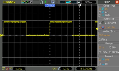

Hello everyone! I have a problem with reterning ticks in line "measure_speed_rpm = speed_reference / LL_TIM_GetCounter(TIM2);". speed_reference is const variable and equals 15000000. When I looked at Serial Monitor, it's indicated: (picture)
That's mean that LL_TIM_GetCounter(TIM2) returns '1' sometimes. Nothing in my code not calling void EXTI1_IRQHandler(void), except EXTI Interrupt. And the main question is - Why it reterns only '1'??? Not 2,3 e.t.c.
Thank you for help!

Thank you for your explanation! But in my case your gess do not realistic. Both edges generated by Hall Sensor in BLDC Motor and have 180 degrees constatly. Also, on the picture in the head meassage you can see, that error of "return 1"  is happennig between normal measuring. Can I make some mistakes in TIM2 setting or functions  LL_TIM_SetCounter(TIM2, 0) and LL_TIM_GetCounter(TIM2) have some peculiarities?
PS: Picture is the wave one of the Hall Sensors. Below you can see my TIM2 setting.
Thank you!

It may be also 0. Division by zero may be handled by simply returning the numerator (that's consistent with "undefined behaviour" prescribed by C99 6.5.5#5 for the case when denominator is zero). You have some nonzero prescaler at the timer, so it may quite well take some time until it overflows, that can cover the rest of the ISR's duration.
@T_Hamdi is probably right. EXTI is asynchronous and fires both edges upon a few ns pulse. It's enough to have some noise superimposed at the signal, or the edge bouncing due to improper termination and/or ground/return arrangement. This whole event may be short enough so that it won't impact visibly the "correct" measurements around it.
Instead of EXTI, use some of TIMx_CHx input capture. That's synchronous and you can also switch on a digital filter on it.
