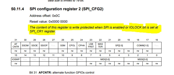

I'm working with a STM32H723ZG and trying to set up SPI2 communication.
I tracked down the issue where my LL_SPI_SetMode(SPI2, LL_SPI_MODE_MASTER) call does not set the Master bit in SPI2_CFG2 to 1, as intended (see Test #1 below).  However, if I call the function twice, the second one does set the Master bit to 1 (see Test #2 below).
Does anyone know how that could happen?

When stepping through in debug mode with the SPI2_CFG2 view open, I can see that the first SetMode call does not turn the Master bit on and the second SetMode call does.  It doesn't make sense to me, since the disassembly code blocks are identical (LDR, ORR, STR sequence with identical arguments).
I've tried both with and without CPU_CACHE_Enable() calls and the result is the same.
Although making the call twice appears to be an effective workaround, this behavior is very unsettling and makes me question whether other configuration commands are "getting through".  Any help is appreciated!

Apparently, there is some issue with the NSS configuration and a MODF (mode fault) is being generated the first time the SPI2 is switched to Master=1.  That MODF automatically switches SPI2 to slave mode (Master=0).  I guess when the SetMode command is issue a second time, that MODF is not acted on and the change to Master=1 stays...
Jan 30, 2025 9:44 AM UTC
Hello @BPric.557
Please ensure that the SPI peripheral and IOLOCK bit (In SPI CR1 register) are disabled before setting SPI_CFG1 and SPI_CFG2 registers.

Thanks, yes the SPI is disabled and IOLOCK is off before making these changes.
This issue appears to be a result of the following 4 conditions:
- SSIOP bit being 0 (low level active for SS)
- SSI bit being 0 (SS input low)
- SSM bit being 1 (software control of SS)
- MASTER bit being 1 (SPI configured as master)
This combination causes an immediate MODF (mode fault) which automatically switches the MASTER bit to 0 (SPI configured as slave). It's intended to work as a feature for resolving multi-master conflicts.
I didn't have this issue with the STM32F7 series or see notes about this in the migration document (STM32F7 to STM32H7), but it seems to be a subtle difference in the SPI feature set.
By setting the SSI bit to 1 before attempting to set MASTER=1, I'm able to avoid this problem.
