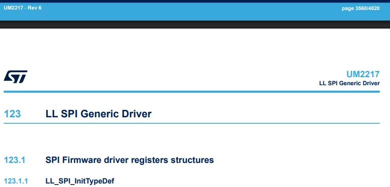

Andrew Neil
Jun 24, 2025 7:57 AM UTC
@mohitha wrote:
Can you confirm whether the STM32H743ZI supports LL SPI driver APIs like LL_SPI_Init, LL_SPI_TransmitData8, etc.?
You have that question the wrong way around!
The STM32H743ZI neither knows nor cares what you use in your source code - all it sees are the binary instructions in its Flash.
The question, then, is whether the Firmware Pack provides these LL APIs.
You can find this on the 'Tools & Software' tab of the STM32H743ZI  Product Page:
https://www.st.com/en/microcontrollers-microprocessors/stm32h743zi.html#tools-software
This links you to the STM32CubeH7 firmware package - see the 'Documentation' tab for documentation:
https://www.st.com/en/embedded-software/stm32cubeh7.html#documentation
The document you require is UM2217, Description of STM32H7 HAL and low-layer drivers:
https://www.st.com/resource/en/user_manual/um2217-description-of-stm32h7-hal-and-lowlayer-drivers-stmicroelectronics.pdf#page=3561

Hello @mohitha ,
First let me welcome you to the STM32 Community.
Please don't repost the same question several times and ensure the continuity of this issue in this thread (Duplicate threads will be deleted).
If you still have issues, don't hesitate to come-back to the Community either as a continuity of this one (when it's related to same initial topic) or with new threads (when it's a new problem).
- The STM32H743ZI microcontroller supports SPI communication using LL drivers (which are part of the STM32Cube firmware package, this includes functions like LL_SPI_Init, LL_SPI_TransmitData8, and others)
- STM32H743ZI device is already supported in the STM32CubeH7 for HAL and LL drivers.
You can refer to the working application applicable for STM32H743ZI and available in this link:
https://github.com/STMicroelectronics/STM32CubeH7/tree/master/Projects/
- To enable LL SPI functions in STM32CubeIDE, you need to define the USE_FULL_LL_DRIVER macro. This directive ensures that the LL driver functionalities, including SPI-related functions, are included in your project. Without this definition, certain LL functions may not be available, leading to compilation errors.
- You can also use STM32CubeMx tool and ensure that the desired SPI peripheral is properly configured in STM32CubeMX before generating the code. Verify that the LL drivers are enabled in the STM32CubeMX configuration (Project Manager > Advanced Settings).
For that, you can refer to these sections: "4.11.3 Advanced Settings tab" and "6.2 STM32Cube code generation using Low Layer drivers", in the UM1718: STM32CubeMX for STM32 configuration and initialization C code generation - User manual
