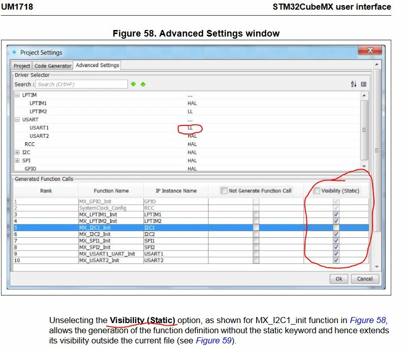

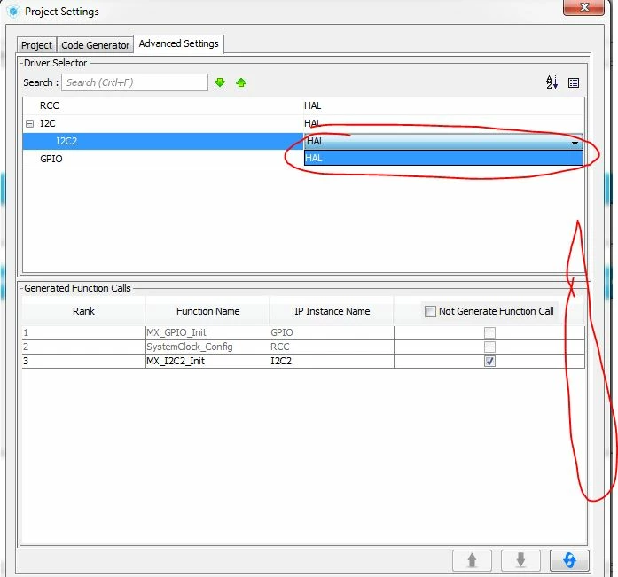

I am currently using version 4.22.1 of MX cube with a F4 board.
I want to use the interface of CubeMX to initialize a device (in this case I2C) but using LL driver. As describe  on the UserManual UM1718 :
In my project setting> advanced setting.
I do not have a column allowing me to validate or not visibility (static) Similarly I only have the option HAL which can be chosen if I click in the driver selector part ...
I can  add the LL library to my project manually, but I would like to know if I'm doing something wrong with Cube MX.

Hello
Lescaudron.Jeremie
Please update the CubeMx version 4.0 to use LL driver.
Best Regards
Imen
