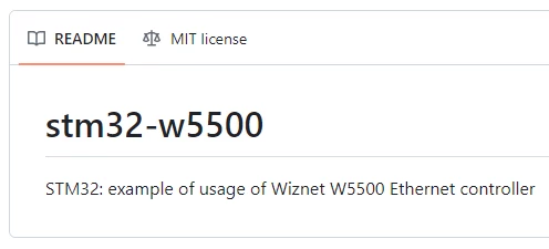

@SGasp.1 wrote:
Do you think i can get inspiration from here to make a working example of st communicating with wiznet7500 in uart ?
https://github.com/afiskon/stm32-w5500/blob/master/Src/main.c
That's something completely different!
It says:
So, yes - that is what it says it's for!

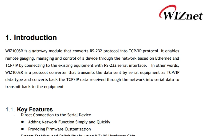

@SGasp.1 wrote:
The wiznet has been programmed with the following fw .
https://docs.wiznet.io/Product/S2E-Module/WIZ750SR/download
So the Serial-to-Ethernet firmware?
So you've read the User Manual:
https://docs.wiznet.io/Product/S2E-Module/serial-to-ethernet-guide#:~:text=Download%20WIZ100SR%20User%20Manual%20v2.2.0
The whole point of such a device is that it's transparent - the things connected to it neither knonw nor care that it's there.

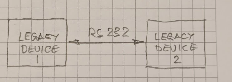

It's for converting a "legacy" situation like this:

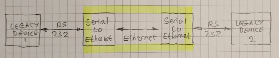

to this:
So the "legacy" devices remain blissfully unaware that they are not actually connected directly by the RS232!

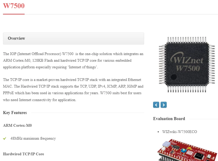

Andrew Neil
Feb 22, 2024 4:51 PM UTC
The Wiznet W7500 has its own on-board Cortex-M0, plus the well-known Wiznet "hardware" TCP/IP Stack:
https://www.wiznet.io/product-item/w7500/
If you've got an stm32f429, why do you need a Wiznet with its own on-board Cortex-M0?
Wouldn't it be better to use a Wiznet with just the  "hardware" TCP/IP Stack?
Or just run a software TCP/IP stack on the stm32f429?

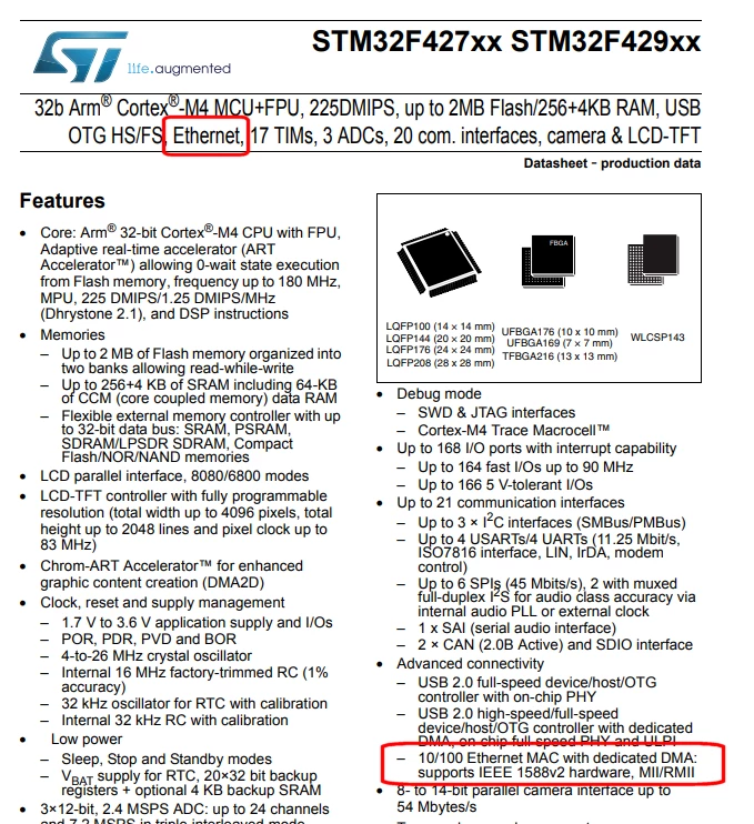

It has Ethernet - so why would you add an external ethernet chip??
