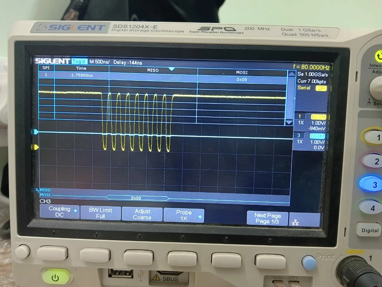

Initially, I just wanted to check if the SPI is working, so I used an oscilloscope. I did get a signal, but it looks different than expected. I sent a single data byte, 0xFE, but the oscilloscope on the MOSI pin shows 0x00
here are my connection IOC Connection
Clk = 64 MHZ
mode :Half Duplex Master
Data Size :8 bits
baud rate : 4MBit/S
CPOL : HIGH
CPHASE : 2 EDGE
gbm
Nov 7, 2024 3:12 PM UTC
Connect the probe to MOSI. Currently it looks like it's connected to SCK.
