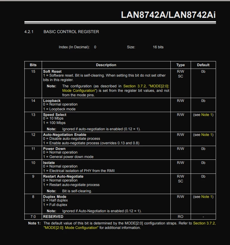

But I'm having issues with the LAN8742A. Especially with the Duplex Mode of the LAN8742. I can't manage to make the duplex mode to Full Duplex . I already manage the speed and autonegociation well, but the Full Duplex mode is not working without AutoNegociation.
What I did in order to manually configure the LAN8742 ?
- Writing in the SMR (Special Modes Register) of the LAN8742 which mode I wanted (Bit 5->7)
- Writing in the BCR (Basic Control Register) of the LAN8742 the speed (Bit 13), the Auto-Negotiation (Bit 12), and the Duplex Mode (Bit 8)
- Specify the Link State via lan8742.c function given by ST

I have the same problem for 10Mb Full Duplex and 100Mb Full duplex. I also try with a Soft Reset (Bit 15 from BRC) but didn't work.
Datasheet from LAN8742 : https://ww1.microchip.com/downloads/en/DeviceDoc/DS_LAN8742_00001989A.pdf
