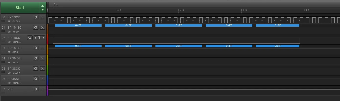

Hi folks,
Board: STM32L432KC Nucleo
IDE: Atollic TrueSTUDIO� for STM32 9.0.0

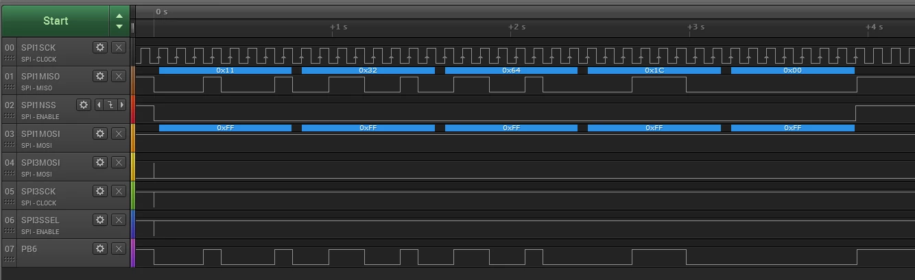

I am using SPI1 as slave and SPI3 as master, both full duplex, DMA mode, in separate communication setups (different time scales). I tested the function as well in circuit as with a function generator and logic analyzer.

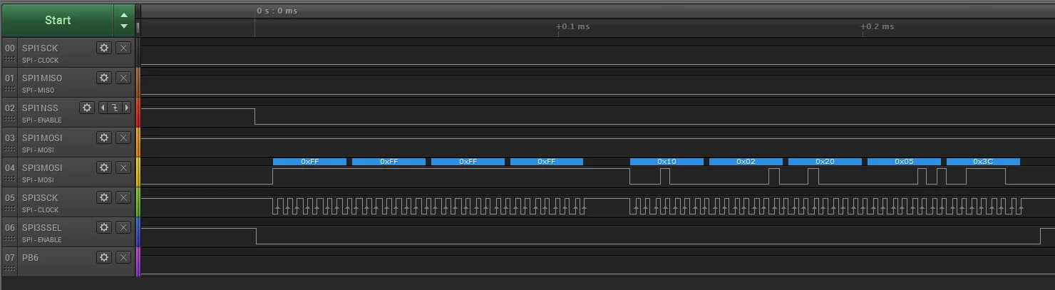

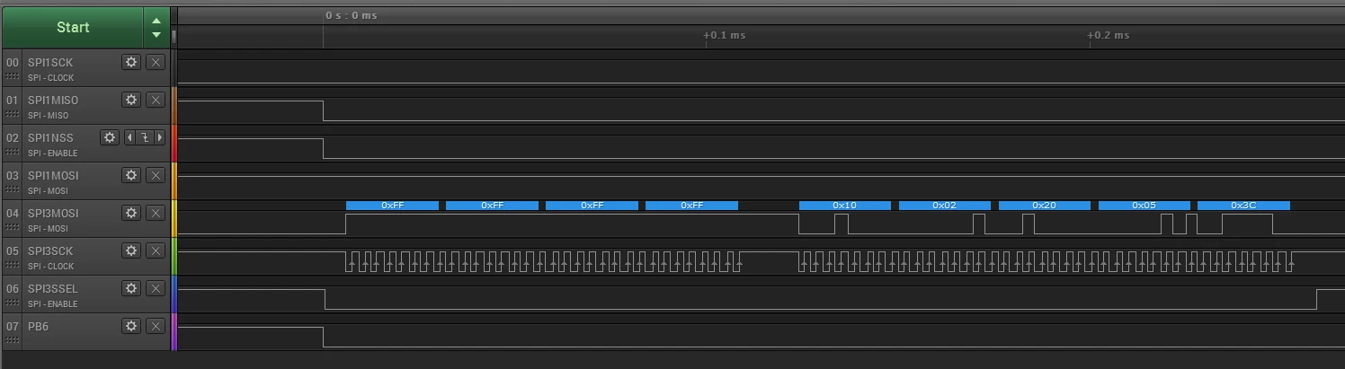

When PB6 is unconfigured (so, probably an input), all works fine, SPI1 is transmitting data when an external clock is applied and NSS is low. SPI3 also works fine as a master in this case (both TX and RX).

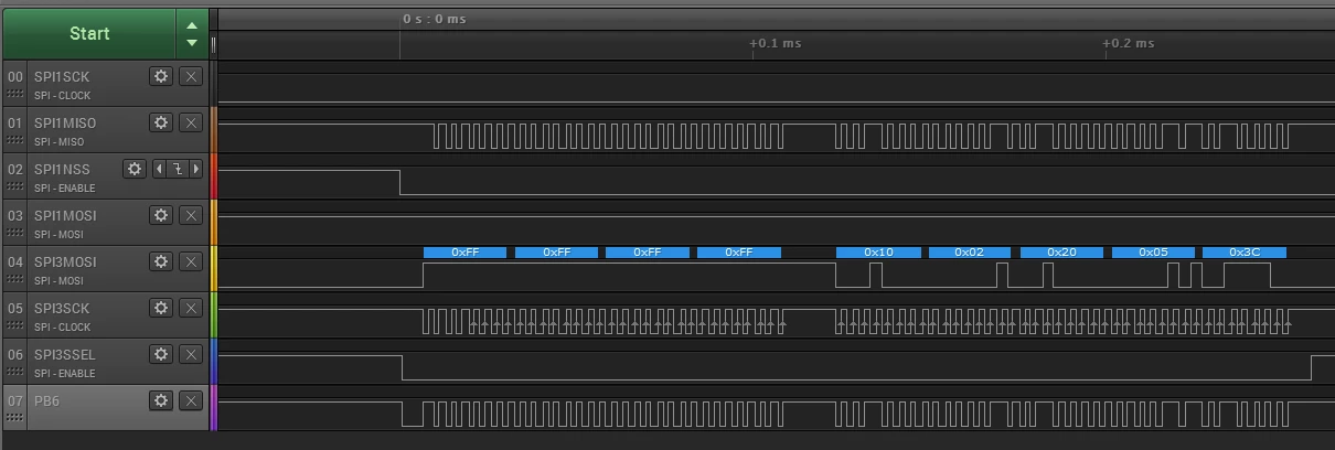

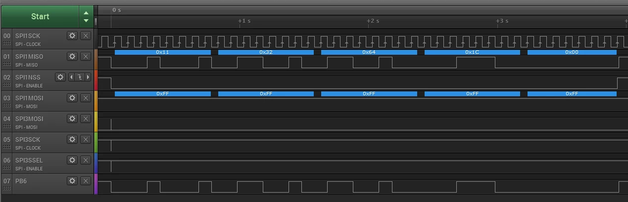

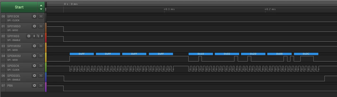

BUT when PB6 is configured as output (Push-Pull in this case), SPI1 does not transmit data via PA6 (MISO) anymore.
Instead, the state of PA6 seems to reflect the state of PB6. Vice versa, PB6 seems to reflect PA6 any time, also when unconfigured.
Strange enough, when PB6 is set to high state, it does not remain high, but pulses with the SPI3 SCK signal. Also, when SPI3 MOSI has a low to high transition, the following SCK low pulse in PB6 and PA6 is missed out (the signal stays high for one clock cycle).
When PB6 is set low, it stays low and PA6 also stays low.
The program is quite barebone and does only contain what is necessary to transmit data via SPI1 and SPI3, and to configure PB6. I am using the HAL (STM32Cube_FW_L4_V1.11.0). The only difference between working and not working state is the config of the PB6 pin:

I will attach some logic analyzer screens.
Has anyone experienced something similar or knows what could be the reason?
If desired, i will attach the SPI configuration later, but i believe that this does not have a lot of influence on the problem.

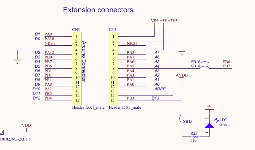

Posted on July 13, 2018 at 10:34
Hi folks,
That was a typical RTFM problem... there is a solder bridge between PA6 and PB6 on the Nucleo-L432KC. Shit. :)
(can be found in the Nucleo-32 user manual UM1956)
Have a nice day!
