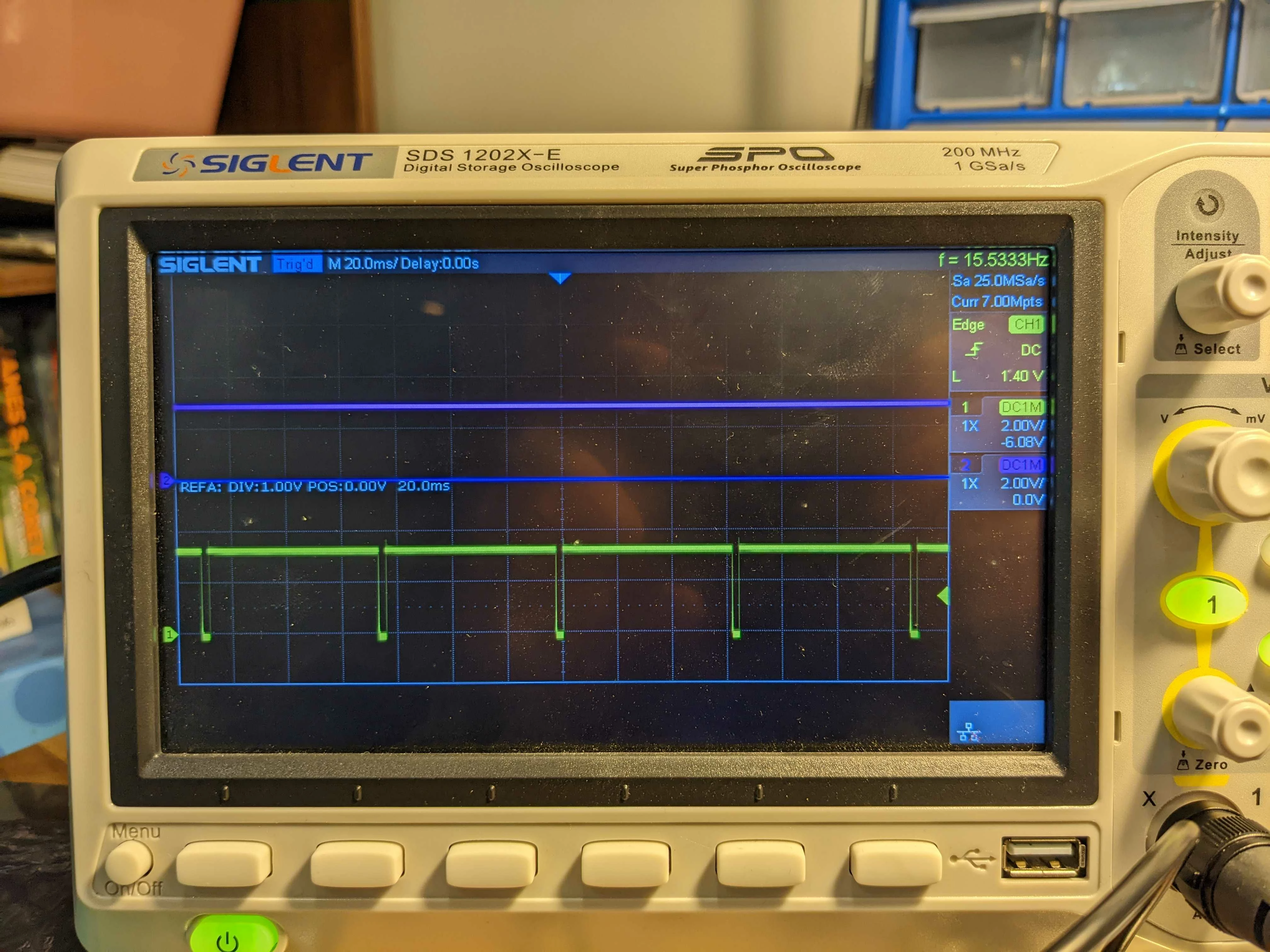

Hello, I'm working on a product that receives updates via the DFU bootloader. I have two batches of the same board received from the same manufacturer, and one batch is behaving strangely as I attempt to use this method to jump to the bootloader.
The code is based off of this tutorial, and works flawlessly on older batches of the board.
However, on a new batch, instead of jumping to system memory for DFU upload, the board will simply reset from the WWDG IRQ. The overall program feeds the WWDG every couple milliseconds, but by the time the program calls the SysMemBootJump() function, it should have disabled the RCC timers and the WWDG interrupt.
In order to demonstrate the issue, I'll attach a sample project I made in CubeIDE that produces the issue. The program will start with a GPIO set low, and after waiting for short period, will set it high, then jump to the bootloader. On the affected batch of boards (the bottom signal) the GPIO line will dip, indicating a hardware reset. The top signal is the a board operating normally, holding the GPIO high while it waits in system memory:
0693W00000WJSWaQAP.jpgThe only difference between these two boards is the batch number of the STM32F405RGT7 itself. The normal board has the following manufacturing information:

It's pretty easy to dismiss this issue as a difference in the two batches of PCB, but I have been able to verify that the normal operations of this part are meeting expectations, it's just this WWDG/DFU situation.
Related Behaviours:
  • The affected board will boot to sysmem and allow DFU if the board is powered up and BOOT0 is pulled high
  • Explicitly disabling the WWDG peripheral clock (RCC->APB1RSTR &= ~RCC_APB1Periph_WWDG) before disabling interrupts via CPSID/__disable_irq() will allow the board to jump to sysmem

I'm truly at a loss here. This is a part that we've had in operation for several years with no revisions. But one batch of PCB's where the only visible change is a different batch of F405's is showing different behaviour that is completely reproducible across the entire batch. I really don't want to use the words "silicon error" but at this point I'm running out of ideas. I simply have no idea why the two chips are behaving differently. I couldn't find anything in the errata or AN2606 about WWDG and how it relates to the sysmem bootloader. My colleagues are similarly stumped.

The processor doesn't normally start with the interrupts disabled/masked, and the code similarly doesn't assume that they are
SYSCFG clock is enabled via AHB2ENR, the memory won't remap without it.
This is the method I used on F2 and F4 boards a decade ago, resets and vectors into ROM, in reset conditions

I have no direct answer to your question. But I strongly suggest you set some marker in a memory that is not initilized by reset. Then you call NVIC_System reset and in the startup code you look up that marker and start the bootloader there.
Tesla DeLorean
Guru
Nov 27, 2022 2:38 PM UTC
Don't use __disable_irq(); there isn't a counter party to this in the loader to enable, and the task is to TURN OFF the interrupts YOU are using, at the peripheral level.
Check the version of the LOADER, I think STM32 Cube Programmer reports this now
SYSCFG has a clock it needs to be enabled to work
Watch what GNU/GCC generates with the stack frame, changing the stack pointer mid-function can be problematic depending on whether registers or stack has been used for auto/local variables.

@Community member​  Considering the same code results in different behaviour across two batches of boards I'm hesitant to agree it's a GNU/GCC issue. I'll take a look at the loader, but I have a couple other questions:
  • "SYSCFG has a clock it needs to be enabled to work"
    • Is there a source I can find on this? Looking through the clock tree and SYSCFG chapters in the TRM, this statement leaves me a little perplexed. Is it derived from the SysClck?
  • "Don't use __disable_irq();"
    • Agreed, we should be disabling the interrupts we use directly.
    • (this is just a curiosity question) I'm not sure what you meant " there isn't a counter party to this in the loader to enable". That if __disable_irq() is used, then the bootloader doesn't re-enable any interrupts (even for use internally)?
@Uwe Bonnes​ That sounds like a more sustainable solution than what we're doing now. I can investigate that too.

@Community member​ The boards use two different versions of the bootloader. The older F405 uses bootloader version 0x31 and the newer (non-cooperative) one uses 0x91. The only difference between the two according to AN2606 is that 0x91 supports SPI and I2C which we aren't using anyway, so it's moot. Are there any other differences that you could be aware of?
Tesla DeLorean

I suppose I should update this! I hate finding forum posts that don't end in a resolution or just "I fixed it myself" with no context.
I tried the methods outlined above on the newer batch of chips to no success. Which still strikes me as odd, but either way, on we go. I also swapped a newer F405 that exhibits this issue with an older F405 on the same PCB just to make sure it wasn't a quirk from a particular batch of PCB's. The issue was still manifesting with the newer chip, and was no longer present on the PCB that had the older chip swapped onto it. We're investigating the supply chain for these newer chips, but I'm 99% certain they aren't counterfeit to begin with. Either way, I do have the hacky solution where I manually disable the WWDG clock before proceeding with the rest of the shutdown, which is what we had to continue with due to timeline pressure.
Thanks for the pointers everyone. I'll be implementing the more correct bootloader jump sequence in future designs (and hope I never run into something like this ever again).
