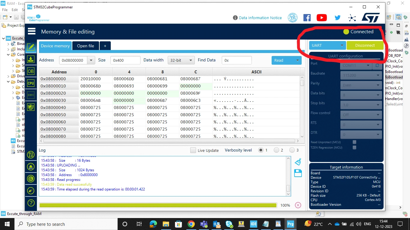

Board :- Custom board with STM32F105RCT6
Description :- I am trying to Jump to internal bootloader when Option Byte for Read Out Protection is set to 1 (RDP Level  1).
  1. When I am jumping to internal bootloader by Disabling the Read out protection I am able to Jump to SRAM and able to bootloader over UART and I can read the Device memory.

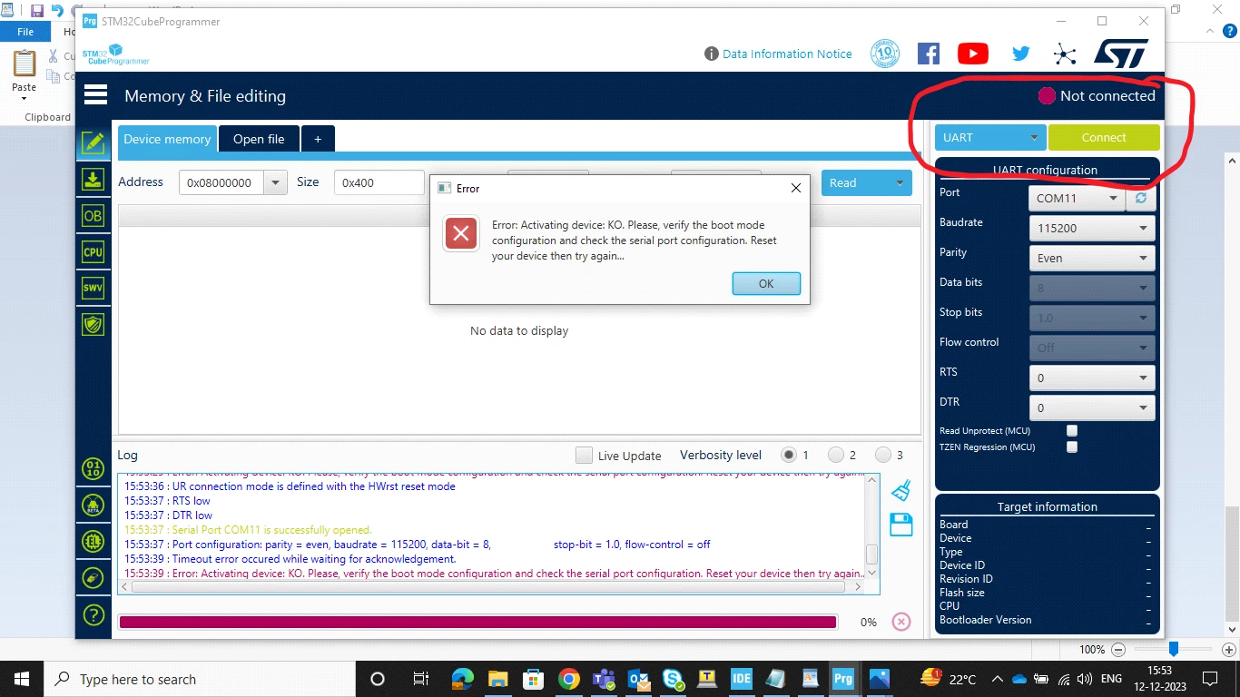

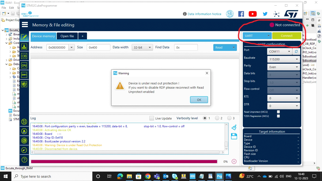

  1. When I am jumping to internal bootloader Enabling Read out protection then I am not able to Jump to SRAM and not able to bootloader over UART and it is asking for Disable the RDP and try again.
  1. After that again I am jumping to internal bootloader and Disabling the Read out protection by software (mention below) after that also I am not able to Jump to SRAM and not able to bootloader over UART and I cannot read the Device memory.

Enabling a "ReaD out Protection" doesn't allow reading the flash... what a surprise! Then setting the RDP=0 and therefore doing a mass erase doesn't allow the (erased) firmware to run... again what a surprise! Maybe read the reference manual first?
