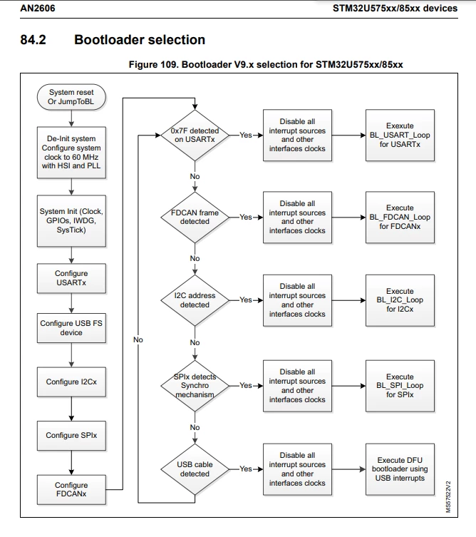

Below you can find the code i'm using to try and make the jump, perhaps the order how things are de-initialised and initialised is to blame but i tried to follow the order as per the diagram in the AN2606 doc.

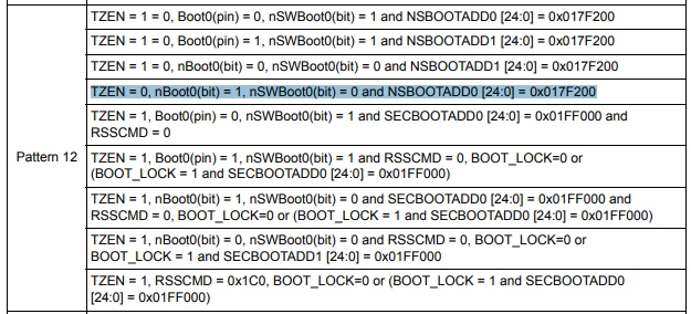

As a boot patter i've selected the highlighted pattern in the screenshot below:

 FLASH_OBProgramInitTypeDef OB_Data;
 OB_Data.OptionType = OPTIONBYTE_USER | OPTIONBYTE_BOOTADDR;
 OB_Data.USERType = OB_USER_TZEN | OB_USER_NBOOT0 | OB_USER_NSWBOOT0;
 OB_Data.USERConfig = OB_TZEN_DISABLE | OB_NBOOT0_SET | OB_NBOOT0_RESET;
 OB_Data.BootAddrConfig = OB_BOOTADDR_NS1;
 OB_Data.BootAddr = 0x017F200;
 uint32_t Nboot0_OB = READ_BIT(FLASH->OPTR, FLASH_OPTR_nBOOT0);
 uint32_t NSWBoot0_OB = READ_BIT(FLASH->OPTR, FLASH_OPTR_nSWBOOT0);
 uint32_t TZEN_OB = READ_BIT(FLASH->OPTR, FLASH_OPTR_TZEN);
 if (Nboot0_OB != OB_NBOOT0_SET || TZEN_OB != OB_TZEN_DISABLE || NSWBoot0_OB != OB_NBOOT0_RESET) {

Okay so it's confirmed the jump into bootloader isn't happening, once SysMemBootJump() is initiated the mcu restarts.
MM..1
Sep 2, 2024 6:12 PM UTC
In your code i see more missunderstanding... When you read and use Pattern xx no jumping is required, but reset MCU. Too in both method reset or jump no UART config help. System code do itself inits and work only on pins listed in AN2606, not any pins you setup...
As first step connect STLINK and setup manualy OB as you plan test. After validate OB setup simply reset or power off on and System loader is started.
