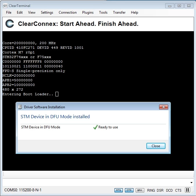

This brought up 'STM32 BOOTLOADER' on the STM32F746G-DISCO for me
void BootDFU(void)
 printf('Entering Boot Loader..
 SCB_DisableDCache();
 *((unsigned long *)0x2004FFF0) = 0xDEADBEEF; // 320KB STM32F7xx
 __DSB();
 NVIC_SystemReset();

Clive1 (HNL)
Explorer
September 11, 2018
Well the forum transition seems to have made a dog's breakfast of the original post, and is apparently too large and malformed to bring up the editor window.
void BootDFU(void)
 printf("Entering Boot Loader..\r\n");
 __DSB();
 NVIC_SystemReset();
