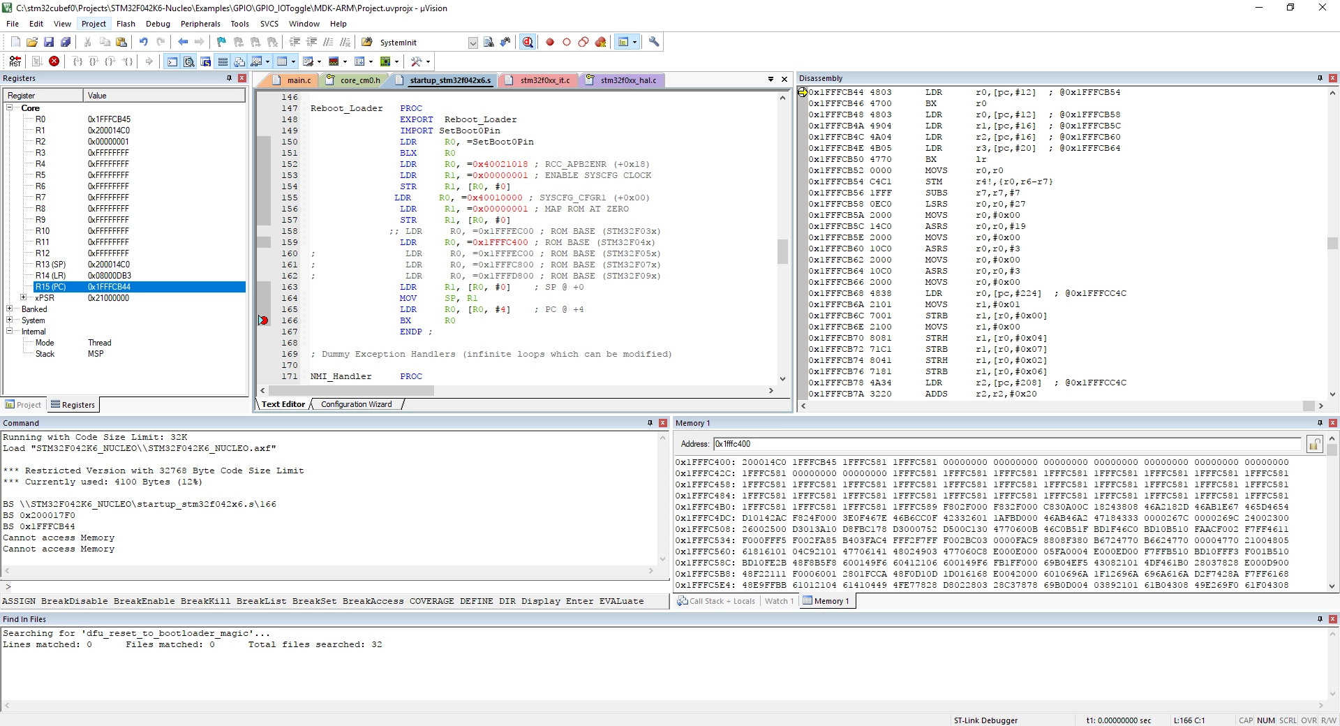

The ,BOOT0 pin PB8 is not available on the CN3 or CN4 connector.  ,
I've used the same code posted above in this thread as it is and in fact the user flash application is handing over the control to system memory bootloader successfully. However the bootloader code ,hands over the control to the user flash application within few mSecs. According to the datasheet of MCU, the bootloader code looks for the BOOT0 pin if the BOOTSEL option bit is not explicitly set to don't check for BOOT0 pin.  ,This presents two solutions. First one is programming the BOOTSEL to skip checking the  ,BOOT0 pin in the bootloader start routine.This will allow the BOOT0 pin to be used as normal GPIO pin for any other operations. The other one is setting the BOOT0 pin thru code using the internal pullup and to HIGH. I've used the second solution in the below posted code
So then I've created a new function that explicitly sets the BOOT0 pin to HIGH before making the jump to the system memory. This change fixed the loop of moving from bootloader to user flash application. The MCU stays in bootloader code. ,
//File : main.c
void SetBoot0Pin(void)
__HAL_RCC_GPIOB_CLK_ENABLE(),
GPIO_InitTypeDef gp,
gp.Pin = GPIO_PIN_8, //BOOT0 pin
gp.Mode = GPIO_MODE_OUTPUT_PP,
gp.Speed = GPIO_SPEED_FREQ_LOW,
HAL_GPIO_Init(GPIOB, &,gp),
HAL_GPIO_WritePin(GPIOB, GPIO_PIN_8, (GPIO_PinState) 1),
//File : startup_stm32f042x6.s
, Reset handler routine
Reset_Handler PROC
EXPORT Reset_Handler [WEAK]
LDR R0, =0x200017F0
LDR R1, =0xDEADDEAD
LDR R2, [R0, ♯ 0]
STR R0, [R0, ♯ 0] , Invalidate
CMP R2, R1
BEQ Reboot_Loader
IMPORT __main
IMPORT SystemInit
LDR R0, =SystemInit
BLX R0
LDR R0, =__main
BX R0
ENDP
Reboot_Loader PROC
EXPORT Reboot_Loader
IMPORT SetBoot0Pin
LDR R0, =SetBoot0Pin
BLX R0
LDR R0, =0x40021018 , RCC_APB2ENR (+0x18)
LDR R1, =0x00000001 , ENABLE SYSCFG CLOCK
STR R1, [R0, ♯ 0]
LDR R0, =0x40010000 , SYSCFG_CFGR1 (+0x00)
LDR R1, =0x00000001 , MAP ROM AT ZERO
STR R1, [R0, ♯ 0]
LDR R0, =0x1FFFC400 , ROM BASE (STM32F04x)
LDR R1, [R0, ♯ 0] , SP @ +0
MOV SP, R1
LDR R0, [R0, ♯ 4] , PC @ +4
BX R0
ENDP ,
Snapshot when the code is jumped to system memory bootloader. Notice the jump to the code location 0x1FFFCB45 as per the memory window showing the value at the reset vector address.

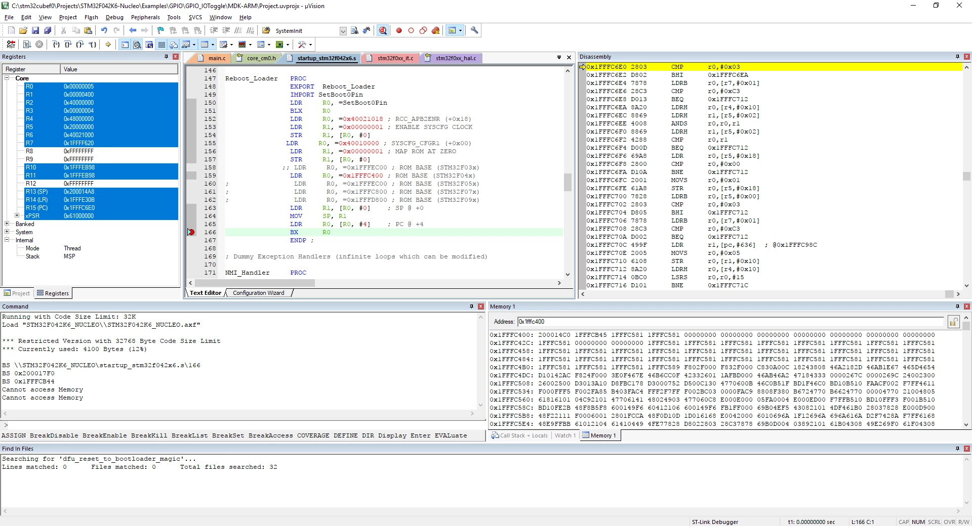

Allowed the code to run for some time. Notice the change in PC register shown in the registers window
