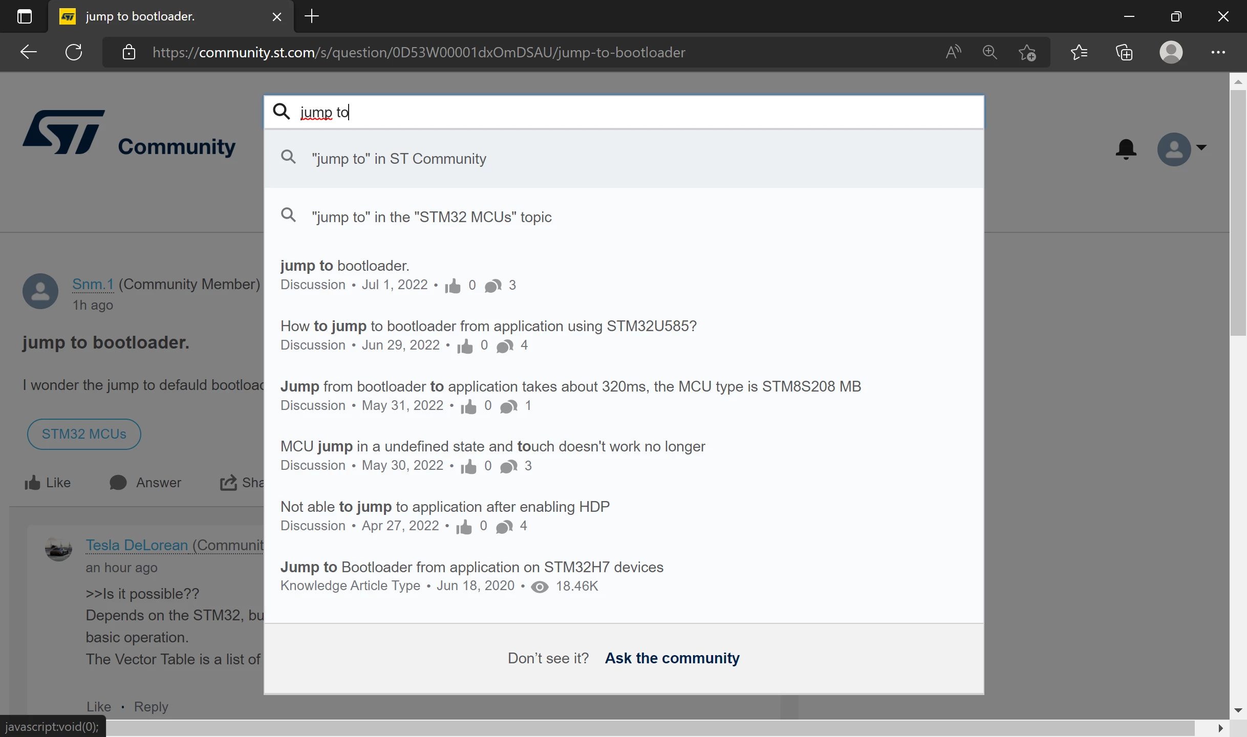

MM..1
Jul 1, 2022 10:48 AM UTC
Try search first ...
Snm.1
Snm.1Author
Jul 1, 2022 11:10 AM UTC
I didn't found, therefore i ask.
MM..1
Jul 1, 2022 11:18 AM UTC
MM..1
Jul 1, 2022 11:46 AM UTC
