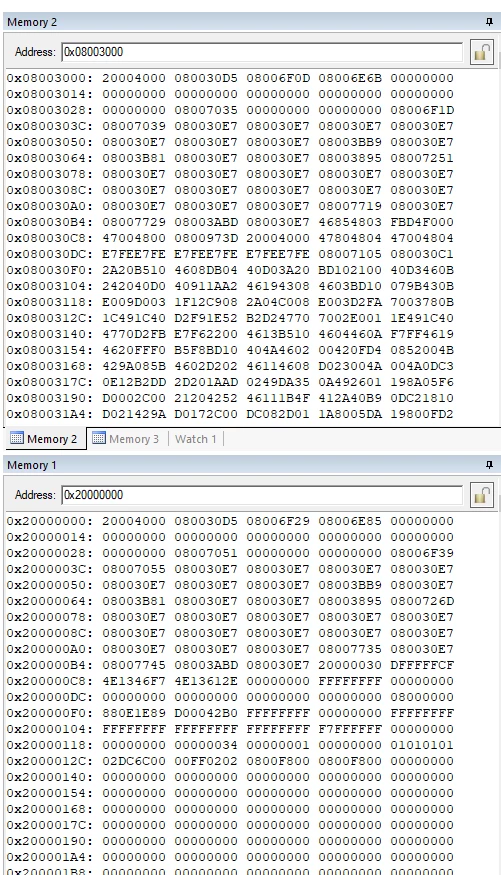

I used memcpy to copy the vector table into RAM. Below shows the results of the memcpy command.
Below is the code I use to copy the vector table and hopefully start to use the new RAM based vector table.

I have been able to verify that my main loop is running, but none of the interrupts are firing.  I have also verified that I successfully copied the vector table to RAM (address 0x20000000).  I used a scatter file to reserve a memory locations 0x20000000 - 0x200000BF are reserved for the vector table.

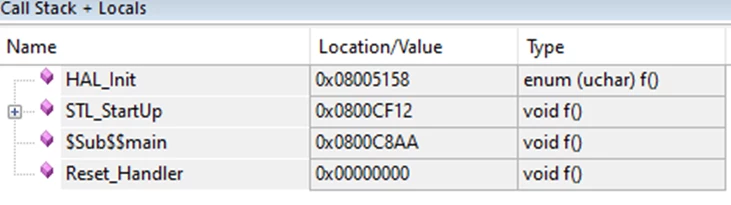

Aug 31, 2023 7:48 PM UTC
I have narrowed down where the issue is located.  We are using a functional safety library.  If I run my bootloader application shifted in flash (no functional safety library) everything works properly.
However, when I run my actual code I can see that there are a number of functions called prior to my main() where I relocate the vector table.  This was causing the application to crash unless I stepped through most of the process (preventing an interrupt).
I believe this code is causing the problem:
  #define GotoCompilerStartUp()  { Startup_Copy_Handler(); SystemInit(); __libc_init_array(); main(); }    /* entry to  main() */
The images below show one of the function calls.  STL_StartUp calls HAL_Init as well as
    SystemCoreClockUpdate(); before my main() is even called.
I have tried placing my code in the SystemInit() to re-locate the vector table, the issue with this is that the scatter file is read/loaded after this point which clears my vector table once more.
Any thoughts on how/where to relocate the vector table in this case?
